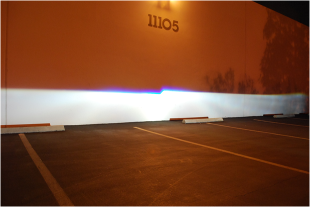

Nick Halstead Posted January 24, 2016 Report Share Posted January 24, 2016 there is no comparison between The Edge OEM HID and a retrofit My OEM HID retrofit Night and day difference between the two. 1 Quote Link to comment Share on other sites More sharing options...
candurin Posted January 24, 2016 Report Share Posted January 24, 2016 Nick, you sure those aren't labelled incorrectly? The sharp cutoff picture should be OEM. Quote Link to comment Share on other sites More sharing options...
fit1446 Posted January 24, 2016 Report Share Posted January 24, 2016 (edited) no i am pretty sure they are right..the oem is in his 15 on the top and the bottom with the sharp cut off is the retro he built.i believe actually that retro cut off is crazy... Edited January 24, 2016 by fit1446 Quote Link to comment Share on other sites More sharing options...
Nick Halstead Posted January 24, 2016 Report Share Posted January 24, 2016 (edited) They are labled correctly 99% of oem HID/LED do not come with a defined cutoff. Some oem setups can achieve a nice more defined cutoff with only swapping to a clear lens (swapping the actually projector lens you see when you look at a projector from outside). Though majority of oem projectors can be out performed by $40. Projectors from morimoto. Thats just a cutoff I googled on the bottom. The first 2 pics are my actual car. Edited January 24, 2016 by Nick Halstead Quote Link to comment Share on other sites More sharing options...
