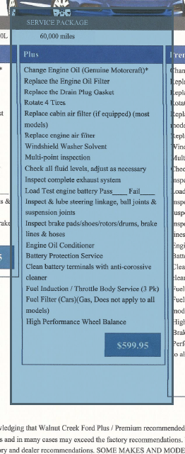

buzzmanable Posted January 21, 2016 Author Report Share Posted January 21, 2016 here is the service that I will be getting. Also, I have provided the YouTube link to the video of the power door not latching. http://youtu.be/5mESbbFSr-0 Quote Link to comment Share on other sites More sharing options...

macbwt Posted January 22, 2016 Report Share Posted January 22, 2016 Wow just wow. I would never pay for that and pay that much. Most of it is not needed. Especially with just 66k. Trans flush and that is not even mentioned and if it has not been done I would recommend changing the transmission fluid. Then radiator fluid and then brake fluid and last but not least power steering fluid. Have you changed the lift struts on the rear hatch? Might be a good idea it sounded as if it was closing hard. New lift struts might make all the difference. here is the service that I will be getting. Also, I have provided the YouTube link to the video of the power door not latching. http://youtu.be/5mESbbFSr-0 2 Quote Link to comment Share on other sites More sharing options...
buzzmanable Posted January 22, 2016 Author Report Share Posted January 22, 2016 So what is a list of things that I can copy and past that I should tell them to check? I see you say the **New Lift Struts**. yes, it does close somewhat hard, especially when around 55 Degrees outside. On the service, what should I swap out for them to do the Trans, Radios, Brake and PS fluids? and 56K miles. I made a *typo* in my original post. Quote Link to comment Share on other sites More sharing options...
fit1446 Posted January 22, 2016 Report Share Posted January 22, 2016 Wow just wow. I would never pay for that and pay that much. Most of it is not needed. Especially with just 66k. Trans flush and that is not even mentioned and if it has not been done I would recommend changing the transmission fluid. Then radiator fluid and then brake fluid and last but not least power steering fluid. Have you changed the lift struts on the rear hatch? Might be a good idea it sounded as if it was closing hard. New lift struts might make all the difference. its ok they are not going to do even half of it anyway Quote Link to comment Share on other sites More sharing options...
fit1446 Posted January 22, 2016 Report Share Posted January 22, 2016 So what is a list of things that I can copy and past that I should tell them to check? I see you say the **New Lift Struts**. yes, it does close somewhat hard, especially when around 55 Degrees outside. On the service, what should I swap out for them to do the Trans, Radios, Brake and PS fluids? and 56K miles. I made a *typo* in my original post. here is the list you give them..... 1) FIX MY DAMN CAR AND FIX IT SO I DONT HAVE TO COME BACK IN TWO DAYS BECAUSE YOU WERE TO LAZY TO ACTUALLY DIAGNOSE THE PROBLEM AND JUST STARTED WITH THE REPAIR THAT PAID THE MOST BILLABLE HRS THAT YOU COULD FINISH THE QUICKEST. there is the list. 1 Quote Link to comment Share on other sites More sharing options...
