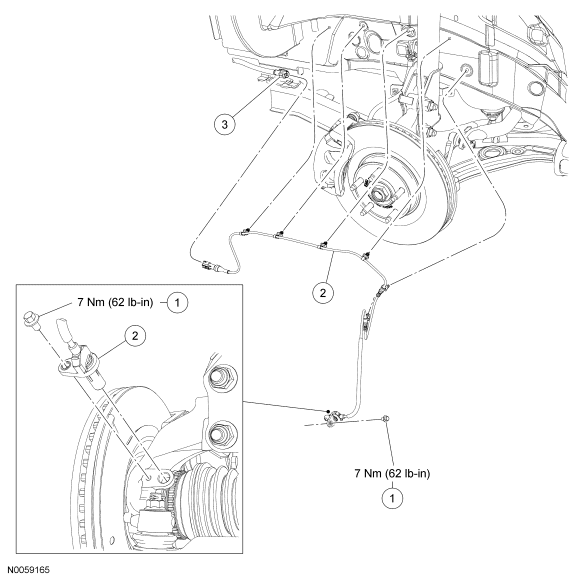

I have found that my 2011 sport has started doing the same thing, but only when I am driving it and come to a complete stop. Can you provide any photos of the areas where these sensors are located so I can inspect/clean them up to see if that takes care of the problem explained? Any information is greatly appreciated and thank you!
mac (macbwt) or one of our other intrepid members might have closeup pics of where the sensors are for the 2011+. The diagrams from the 2007 FSM:
FRONT
Item Part Number Description
1 W500010 Wheel speed sensor bolt
2 2C204 RH/ 2C205 LH Wheel speed sensor
3 — Wheel speed sensor electrical connector (part of 14290)
Removal and Installation
  1. Remove the wheel and tire assembly. For additional information, refer to Section 204-04 .
  1. Remove the retainers and position the fender splash shield aside.
  1. Disconnect the wheel speed sensor electrical connector.
  1. Disconnect the 6 pushpin fasteners.
  1. Remove the front wheel speed sensor bolt and the wheel speed sensor.
    • To install, tighten to 7 Nm (62 lb-in).
  1. CAUTION: The wheel speed sensor harness must be routed as shown or damage to the harness during vehicle jounce and rebound can occur.
    To install, reverse the removal procedure. post-23566-0-04483400-1452083271_thumb.gif
