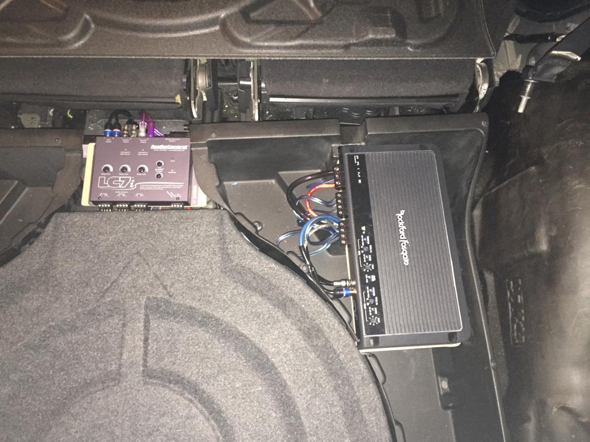

fit1446 Posted December 6, 2015 Author Report Share Posted December 6, 2015 If it is like the 2015, it is in the rear driver side quarter panel. not sure what you are refering to that is located there happy hour? in my 10 there is no room behind that panel to put anything. i picked a spot that made the most sense...had to modify one of the trays next to spare tire but i think it came out well. heres a pic... 1 Quote Link to comment Share on other sites More sharing options...
HappyHourSport Posted December 6, 2015 Report Share Posted December 6, 2015 Yeah there isn't much room back there on a 2015 either. I was able to squeeze the LC7i behind the factory amp and crossovers will be mounted in there also. My Alpine amp will be going the same place as yours. Looks good! Quote Link to comment Share on other sites More sharing options...

fit1446 Posted December 7, 2015 Author Report Share Posted December 7, 2015 So one piece of advice if you haven't cut into the tray yet... Make sure the amp is low enough below your floor panel. And the post I had to cut out is actually a sort of stop for the removable floor panel... It still functions fine but it had to get cut. Quote Link to comment Share on other sites More sharing options...
