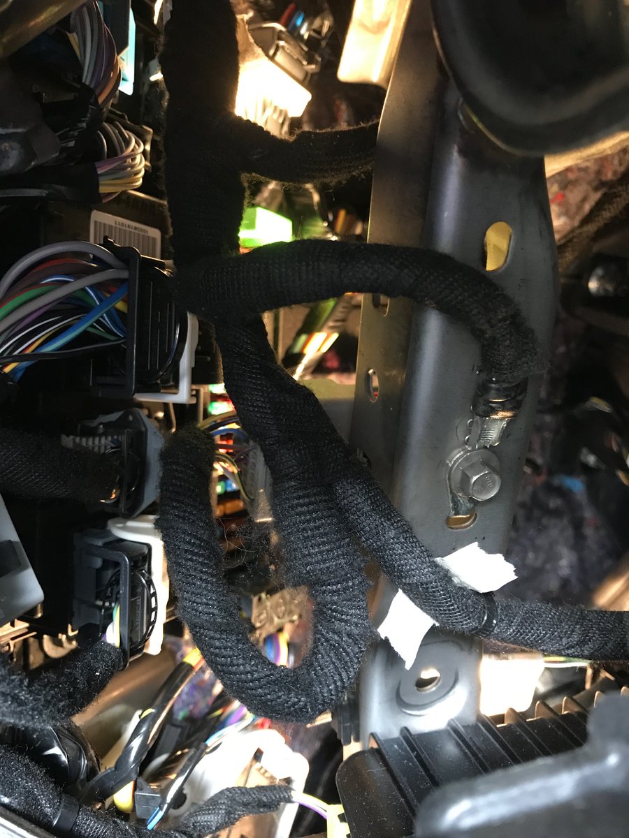

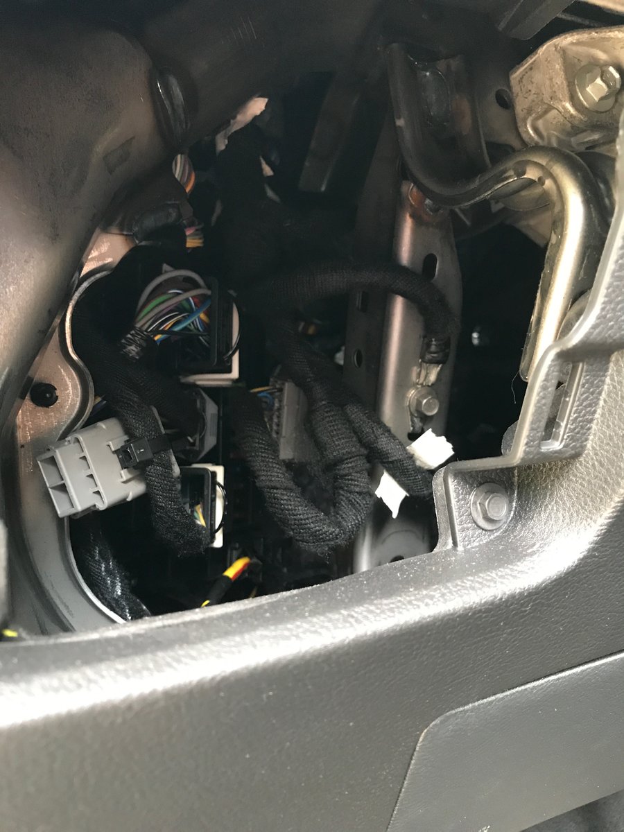

tpm419419 Posted March 11, 2019 Report Share Posted March 11, 2019 What year is it? If 15 or newer it’s to left of steering wheel by knee height. It’s almost useless except for shining a flashlight. You will need to go under the dash as the fuse panel is tucked up way inside i used the top left fuse I think number 23 Quote Link to comment Share on other sites More sharing options...

rhoov Posted March 11, 2019 Report Share Posted March 11, 2019 Mine is a 2018. I do not see anything that resembles a “drawer” but there is a removable panel That reveals the same view as in your picture. So, I guess some are calling this a drawer??? Quote Link to comment Share on other sites More sharing options...

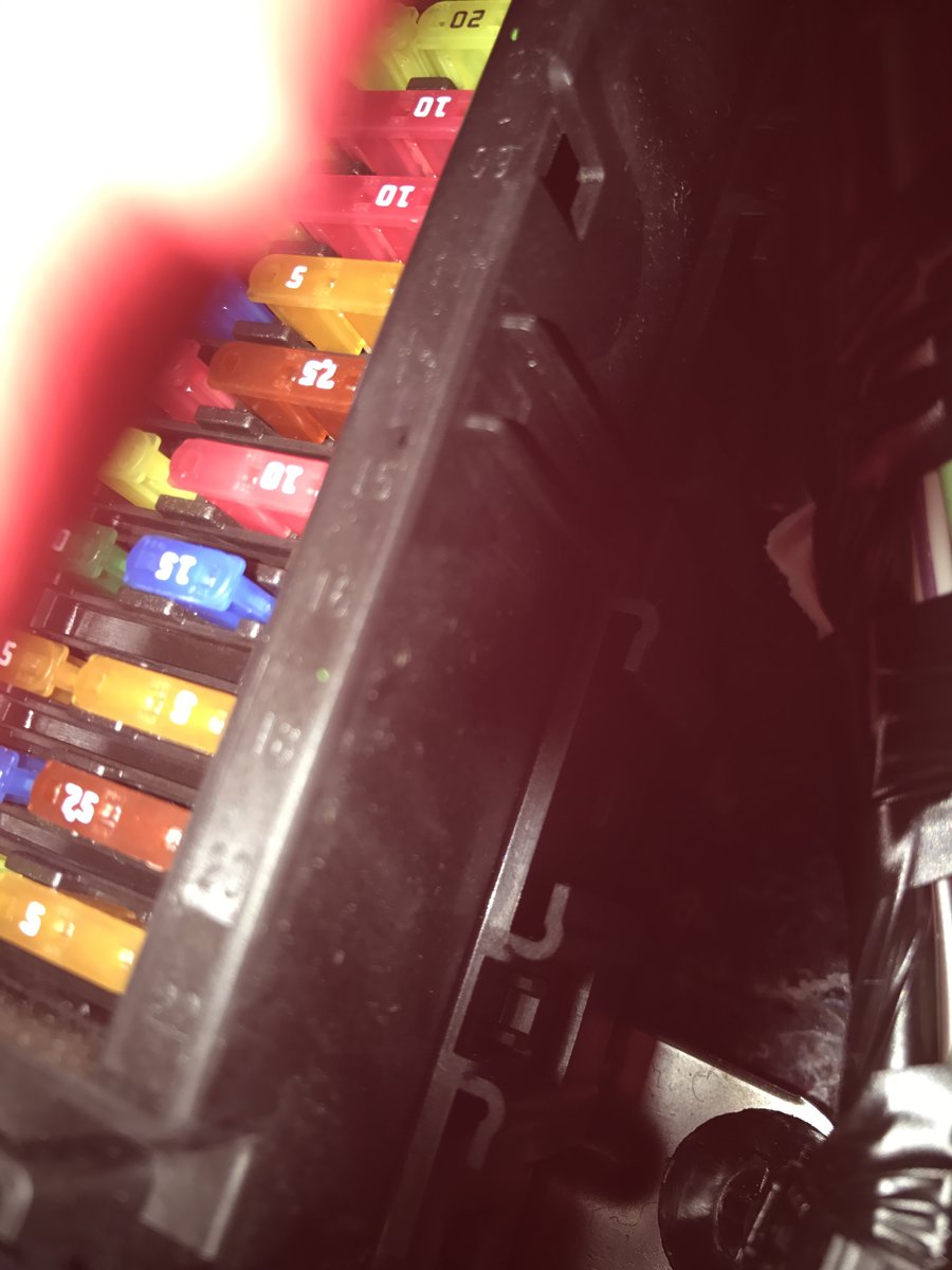

mrthejuice Posted May 30, 2022 Report Share Posted May 30, 2022 (edited) tpm419419, Did you ever figure out how to access that interior fuse box? Your pictures are worth the proverbial 1000 words.... it's impossible. There is even a lip around the top of the fuse box that prevents you from touching a micrometer to both test tabs. I'm surprised there isn't a video somewhere. Thanks Edited May 30, 2022 by mrthejuice Quote Link to comment Share on other sites More sharing options...
tpm419419 Posted May 30, 2022 Report Share Posted May 30, 2022 You need To go under the dash. Taking the access panel off is only good if having someone shine a flashlight through. Basically you need to contort yourself and get on your back to look up under the dash. I hooked up a dash cam power wire so it can be done. good luck Quote Link to comment Share on other sites More sharing options...
