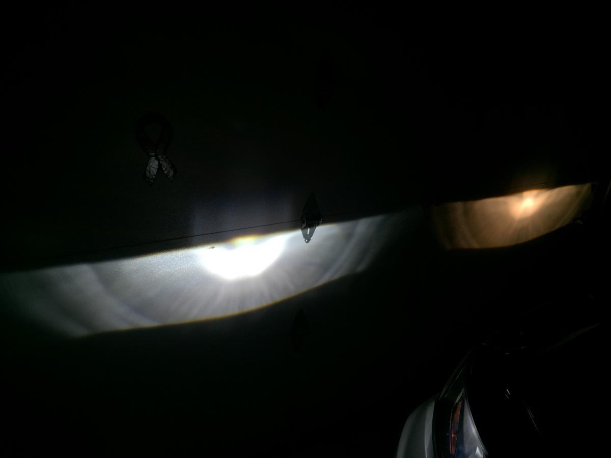

dave80 Posted December 5, 2015 Report Share Posted December 5, 2015 Using diode dynamics 5000k hid kit with zero issues btw. Quote Link to comment Share on other sites More sharing options...

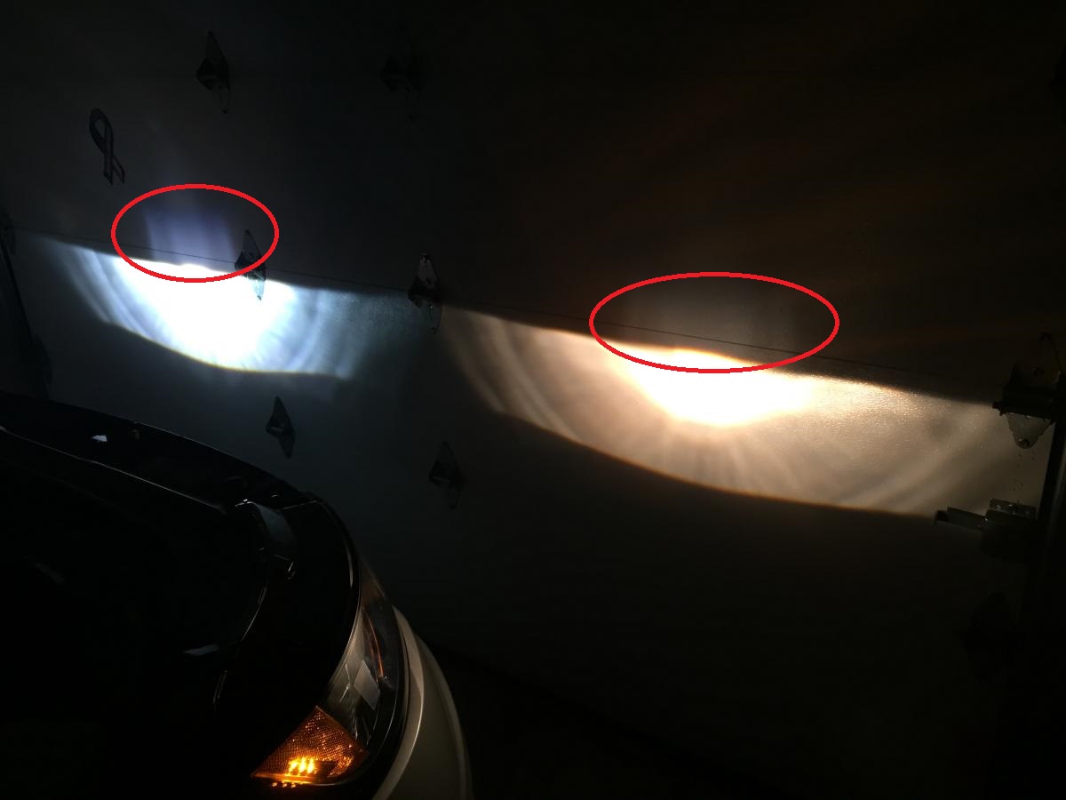

omar302 Posted December 5, 2015 Report Share Posted December 5, 2015 Using diode dynamics 5000k hid kit with zero issues btw. Those images reminded me of one difference in projectors for HID & Halogen lamps. Notice the slight light glare above the cutoff line? This is intentional on Halogen projectors meant for some light to bleed upwards to illuminate road signs, especially overhead. When an HID light is retrofitted in a halogen projector, this "bleed" becomes much more (HID is ~2X brighter than Halogen). Some retrofitters covered these holes, also referred by some as squirrel finders. Quote Link to comment Share on other sites More sharing options...
Nick Halstead Posted December 5, 2015 Report Share Posted December 5, 2015 Using diode dynamics 5000k hid kit with zero issues btw. Not typically the best way to compare them. Way way too close to the wall Quote Link to comment Share on other sites More sharing options...
