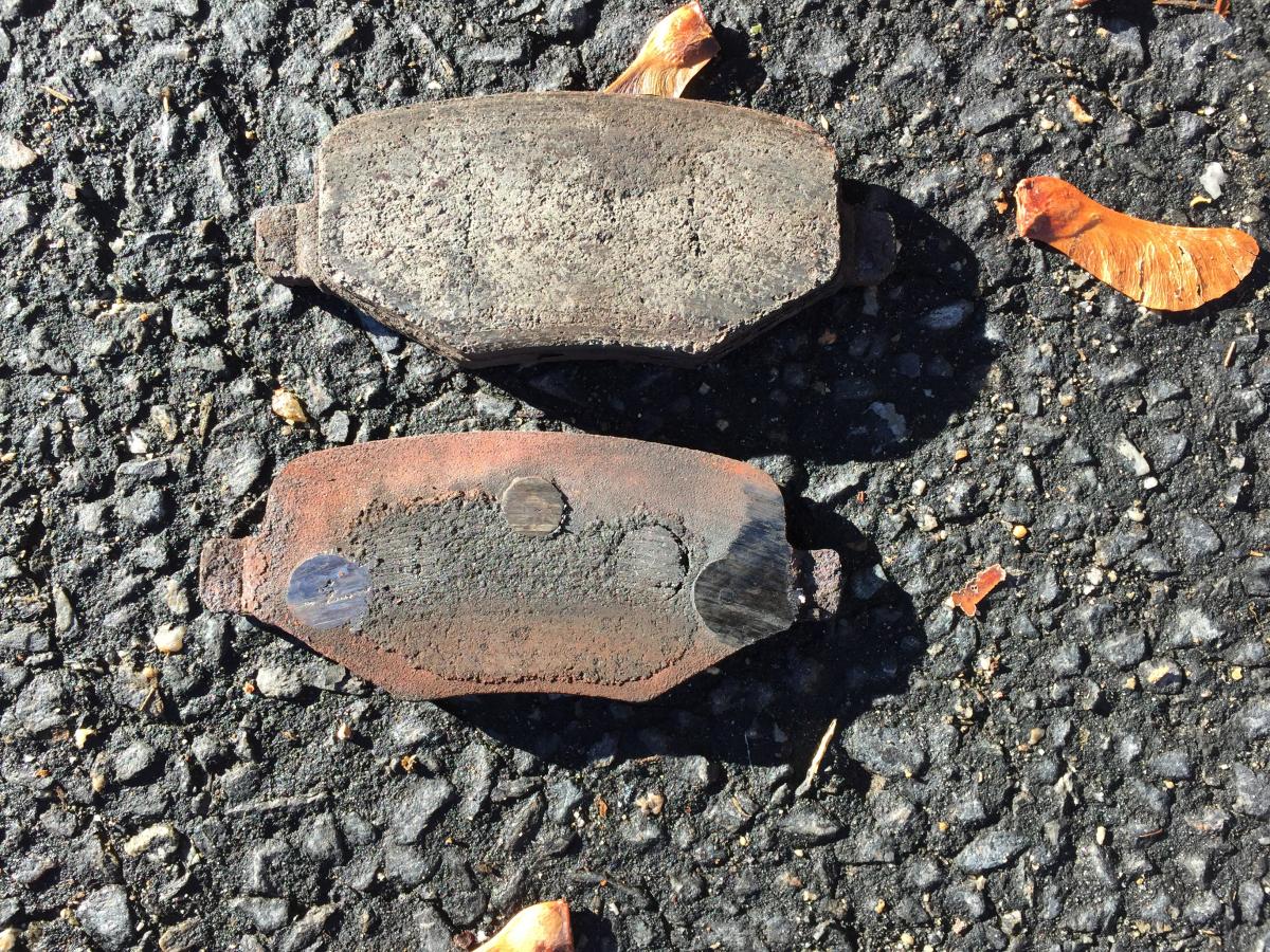

funhouse69 Posted November 15, 2015 Author Report Share Posted November 15, 2015 I have not experienced this with the 2008 or the 2011 models and torque them to 100. Wonder if the lugs are smaller? I have not noticed any difference between the 2008 and 2011 as far as the lugs. Your brakes seem awful low on mileage to be shot like that. Might be another issue you may want to monitor this closely. Rusty brackets on the brakes seems to be a main issue for a lot of the Edge/Explorer brakes. I would go with rust as the reason that one wheel was worn so bar, the other rear still had probably 50 - 60% and the fronts had probably 75%. We cleaned up all the rust and put a little brake greese on the clips so hopefully it won't happen again. I've had it for just about 3 years but work only 5 miles from home and the rest of the miles are long trips so it isn't used that much. See the attached photo from of the Rear Driver Side Pads. Quote Link to comment Share on other sites More sharing options...
WWWPerfA_ZN0W Posted November 15, 2015 Report Share Posted November 15, 2015 Movement is what helps keep rust from building up, the other is regular maintenance. Being in the salt belt, you can def see the pads (and other components) get as bad as in the pic. That's why mfrs specify Mileage AND Time for service intervals ... Quote Link to comment Share on other sites More sharing options...
