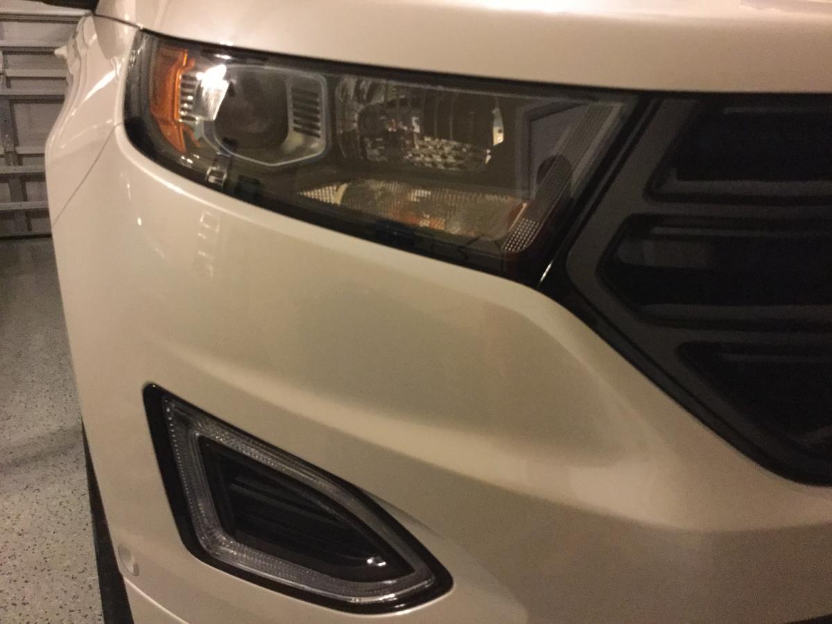

anile_eight Posted November 6, 2015 Report Share Posted November 6, 2015 My wife asked me what they were for and coming from a VW historically those are flash to pass and when I went to show her... the HID lights came on and the shutters moved up. I can't say I was expecting that. Is there anyway to change this so the inner headlights are flash to pass instead of the HID lights? I thought it was kind of odd. Again I know with VW I could go into the comupter with Vagcom and change any and all settings I wanted but from my research there is nothing like that for Ford. 1 Quote Link to comment Share on other sites More sharing options...

anile_eight Posted November 7, 2015 Author Report Share Posted November 7, 2015 HID versions have extra high beam coils in their H15 DRL bulbs.Extra coil? Maybe I don't quite understand. From what I know they have the HID builb in the projector and I always thought that had 1 coil. Then the halogen light on the inners. So there is not a hidden way to activate these lights? Quote Link to comment Share on other sites More sharing options...
redlancer Posted November 7, 2015 Report Share Posted November 7, 2015 (edited) If you mean the high beam side of the bulb being used for the DRL then no. There's only 2 wires on the harness leading to the 3 terminals on the bulb from what I remember. What I thought about trying (though likely wouldn't be entirely legal) was wiring a relay from the high beam shutter circuit to activate the high beam coil in the DRL. Edited November 7, 2015 by redlancer 1 Quote Link to comment Share on other sites More sharing options...
anile_eight Posted November 7, 2015 Author Report Share Posted November 7, 2015 If you mean the high beam side of the bulb being used for the DRL then no. There's only 2 wires on the harness leading to the 3 terminals on the bulb from what I remember. What I thought about trying (though likely wouldn't be entirely legal) was wiring a relay from the high beam shutter circuit to activate the high beam coil in the DRL. I wasn't trying to make them DRL i was just wondering if they would ever work for flash to pass instead of having the HIDs come on for half a second if it was during the day whicih is not good for the HID bulb. I'd rather that happen to a much cheaper halogen bulb on the inners. Now that you mention the wiring to the high beams thats not a bad idea. More light the better:) haha. Quote Link to comment Share on other sites More sharing options...
