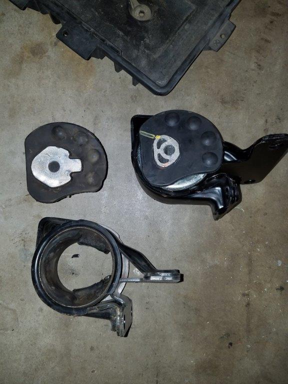

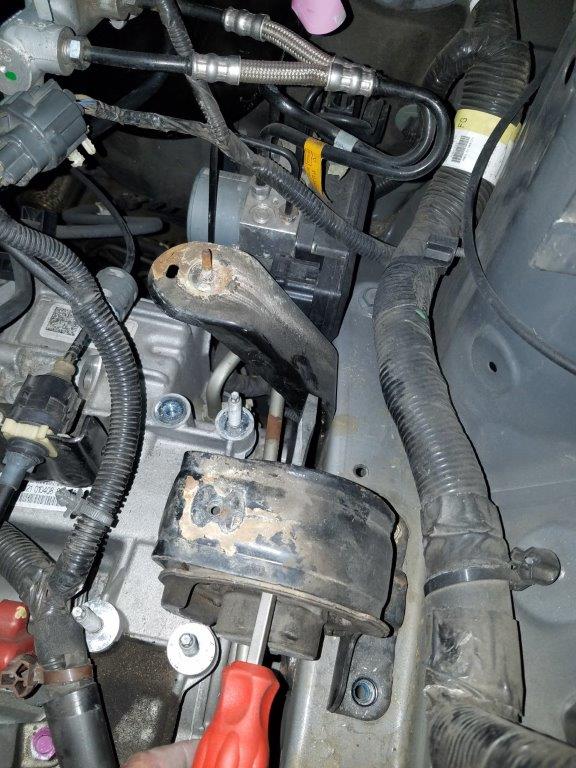

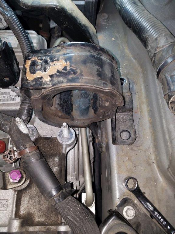

autom8r Posted January 22, 2017 Report Share Posted January 22, 2017 I just replaced the dog bone yesterday. It took about 20 minutes. The transmission mount on the driver side I replaced in October. I had the same symptoms you are experiencing. To get to this mount, the airbox and battery must come out. The battery tray itself is bolted to the mount in question. Replacement of that part is a real PITA, especially if you have the towing package. You'll need to jack up the transmission to align the new mount. Ford bolts the mount from the top and from the sides into the frame of the car. After replacement, the rumble was gone. The old mount looked good, but after its removal you could tell it was worn out. I was able to easily pass a screw driver through the mount. I can post pictures if you want to see them. Happy Trails. 1 Quote Link to comment Share on other sites More sharing options...

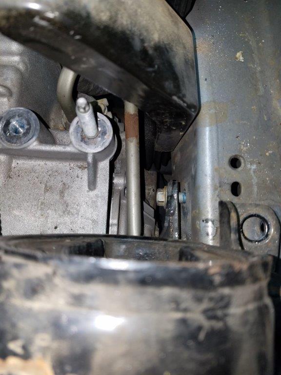

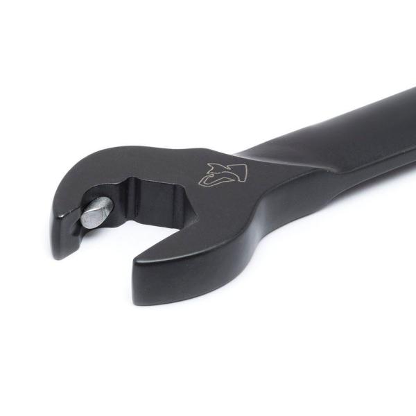

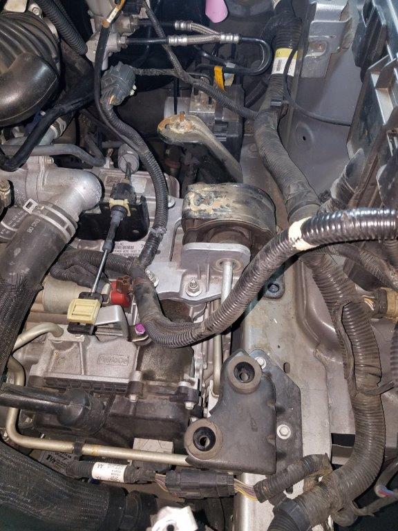

autom8r Posted April 3, 2017 Report Share Posted April 3, 2017 Nvguy44: Here are some pics of the operation. Part Number Get a set of ratcheting, open end wrenches Remove your air filter box, intake tube, battery and battery tray. The battery tray actually bolts into the isolator. Put your floor jack in this location and support the transmission. Do not jack up, just mild upward pressure here. Later you may need to move this up and down a little to reinstall the mounting brackets. Rubber completely sheared. Transmission mounting bracket and center bolt removed.. 3 of 4 frame side bolts removed. This is the bitch. The transmission cooler lines run right over the top of the bolt. The bolt is every bit as long as the opening is wide. Sockets and closed ratchet box wrenches won't work here. Conventional open end wrench will take forever. Note the location of the isolator bracket and the bracket at the top of the picture. The bracket at the top has two bolts going into the frame. Yeah, I thought of that too. Old vs new. New installed. Work the jack a little to get the transmission bracket to align. Obviously, you bolt the mount to the frame and then bolt the transmission mount to the transmission. Work the jack and install the center bolt. Vibration gone. Happy trails. 4 Quote Link to comment Share on other sites More sharing options...
