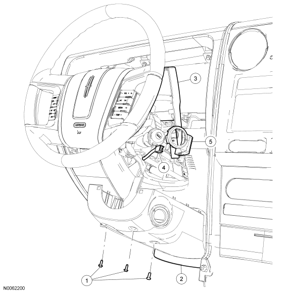

WWWPerfA_ZN0W Posted November 5, 2015 Report Share Posted November 5, 2015 (edited) Ok. So we are back to two possibilities from what I can see (from here ). A] The PATS system needs to be cleared out and the keys re-linked, and/or B] the PCM has something going on with it. Assuming of course that the batteries discussed truly check out, and that the ignition switch is 100% working fine. I still say change the batteries in the fobs, just for the heck of it, and see if that makes a difference. The cost is so minimal. EDIT: I have not heard of the PATS transceiver going bad, but that's another thing to keep in mind. Any issues you have noticed with the instrument cluster itself? IF you want to look at the transceiver (#5): Removal and Installation Remove the 3 screws and the lower steering column shroud.Position the upper steering column shroud aside.Disconnect the electrical connector and remove the PATS transceiver. NOTE: Replacement of the PATS transceiver does not require the PATS keys to be programmed into the instrument cluster again. To install, reverse the removal procedure. Edited November 5, 2015 by WWWPerfA_ZN0W 1 Quote Link to comment Share on other sites More sharing options...
akirby Posted November 5, 2015 Report Share Posted November 5, 2015 But a PATS problem doesn't usually allow the engine to crank at all, right? Other possibilities are the crankshaft position sensor or the PCM itself. Possibly a bad battery ground to chassis? Quote Link to comment Share on other sites More sharing options...
WWWPerfA_ZN0W Posted November 5, 2015 Report Share Posted November 5, 2015 No, a PATS problem will allow cranking, but will not let the injectors fire. Quote Link to comment Share on other sites More sharing options...
akirby Posted November 5, 2015 Report Share Posted November 5, 2015 I wonder if that changed at some point? I see older references to crank but no start, but this was quoted from the repair manual for a 2010 F150: Principles of OperationThe ignition key read process is initiated by turning the key to the ON or START position. When a valid PATS key is turned to the ON or RUNposition the PCM queries the PATS transceiver over circuit 1215 (WH/LG). The transceiver then reads the key code and sends the code to the PCM over circuit 1216 (GY/OG). The PCM then validates the read code against stored authorized keys. If the codes match, the PCM then enables the starter using circuit 1785 (LG/VT) and turns on the anti-theft indicator for 3 seconds by applying ground tocircuit 1269 (OG/RD). If the codes do not match, the starter remains disabled and the vehicle does notstart. The PCM then illuminates or rapidly flashes the anti-theft indicator by applying ground to circuit 1269 (OG/RD). 1 Quote Link to comment Share on other sites More sharing options...
WWWPerfA_ZN0W Posted November 5, 2015 Report Share Posted November 5, 2015 Here is what the 2007 Edge FSM says: PATS Operation The PATS function is controlled by the instrument cluster. With this type of PATS, there are parameters that need to be reset if either the instrument cluster or the PCM (or both) are replaced. Refer to Passive Anti-Theft System (PATS) Parameter Reset in this section. When the PATS key is turned to the ON or START position, the instrument cluster initiates the key interrogation sequence by sending a voltage signal to the PATS transceiver. The transceiver then uses its antenna to bounce a signal off the transponder in the PATS key. This process "reads" the PATS key identification code and sends the key identification code back to the instrument cluster, which interprets it and determines if it matches one of the stored key codes. If it does match one of the stored key codes, the instrument cluster will send a message to the PCM to ground the starter relay solenoid coil and to also allow the fuel injectors to operate. If it does not match one of the stored key codes, or it is only a partial key read or no key read, the instrument cluster will send a message to the PCM to not ground the starter relay solenoid coil and not allow fuel injector operation. The anti-theft indicator in the instrument cluster will flash (or may glow steadily) and the instrument cluster will store one or more DTCs. All elements of PATS must be functional before the vehicle will start. If any of the components are not working correctly, the vehicle will not start. If the instrument cluster must be replaced for any reason (PATS concerns or instrument cluster concerns), the PATS keys must also be programmed into the new instrument cluster. Refer to Integrated Keyhead Transmitter (IKT) Key Programming Using Diagnostic Equipment in this section. Quote Link to comment Share on other sites More sharing options...
