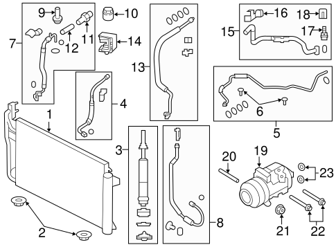

WWWPerfA_ZN0W Posted October 9, 2015 Report Share Posted October 9, 2015 (edited) The 2007 FSM points to this as cause: A/C pressure switch (ACPSW) or ACP transducer sensor circuitsPart #11 in this illustration: 6F9Z19D594AA autom8r has previously mentioned that a bad CHT (cylinder head temperature 9L8Z6G004C) sensor can do this also. Get the codes from the OBD II system to see if they are of any help in this issue. In case there are followon AC issues: http://www.fordedgeforum.com/topic/12884-08-edge-ac/?do=findComment&comment=100146 Edited October 9, 2015 by WWWPerfA_ZN0W 1 Quote Link to comment Share on other sites More sharing options...
