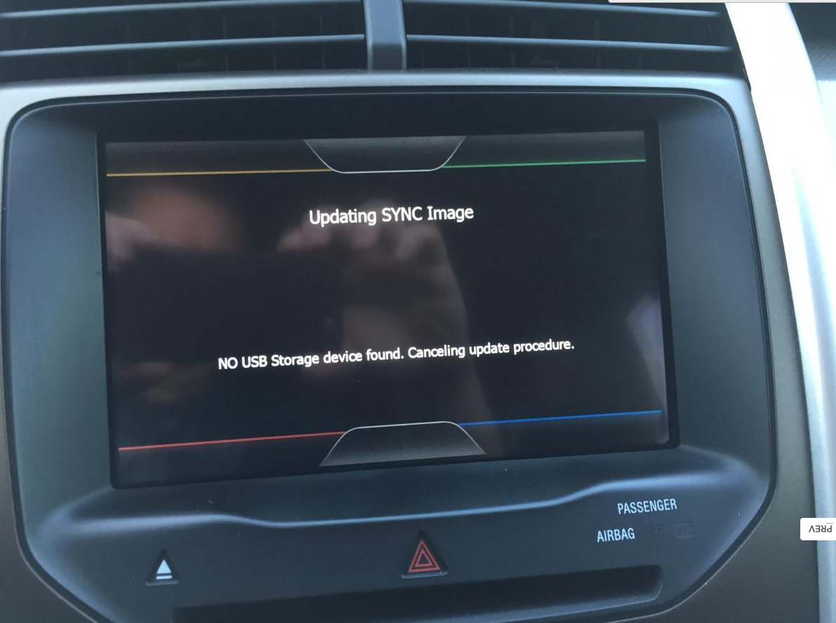

xK317Hx Posted October 8, 2015 Report Share Posted October 8, 2015 (edited) So I'm all set to take my Edge into the dealer after them telling me the screen was dead due to something going wrong with the update. Then I see this just before I opened the door to get out at work this morning. Weird stuff. Edited October 8, 2015 by xK317Hx Quote Link to comment Share on other sites More sharing options...
drpepper Posted October 8, 2015 Report Share Posted October 8, 2015 So do you take the USB stick & do again? Or just let dealer do? Quote Link to comment Share on other sites More sharing options...
xK317Hx Posted October 8, 2015 Report Share Posted October 8, 2015 That screen only pops up when I remove my key. The USB stick even lights up and my phone (when plugged in) makes the charging sound. As soon as I turn the car on it all goes away, and the USB ports become inactive. Had to reschedule for next Tue as the APIM didn't come in. Quote Link to comment Share on other sites More sharing options...
FordIVTteam Posted October 9, 2015 Report Share Posted October 9, 2015 On 10/8/2015 at 6:03 PM, xK317Hx said: That screen only pops up when I remove my key. The USB stick even lights up and my phone (when plugged in) makes the charging sound. As soon as I turn the car on it all goes away, and the USB ports become inactive. Had to reschedule for next Tue as the APIM didn't come in. xK317Hx, Glad you were able to get an appointment. Keep me posted. Shaay Quote Link to comment Share on other sites More sharing options...
xK317Hx Posted October 10, 2015 Report Share Posted October 10, 2015 (edited) Well after having my screen taunt me I decided to try something. I notice that the "insert USB" message was popping up after about every 5th time I'd start to get out of the car. Today on my way back from lunch I noticed it popped up after starting the car, which it hadn't done before. So while the car was running I inserted the USB stick...nothing no love. I thought about it and came up with the idea that if I can get the screen to come on while the car was running maybe a NEW USB stick would be the answer. Turns out it was. Cycled the key about 5-6 times with the new USB in the slot and BAM! Back to life. Everything seems to be working fine. Siri works, texts work, nav works, I will probably keep my appointment next Tue with the Dealer so they can check everything out. Edited October 10, 2015 by xK317Hx 1 Quote Link to comment Share on other sites More sharing options...
