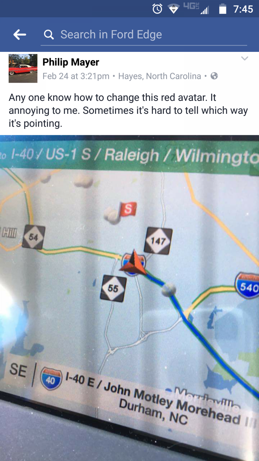

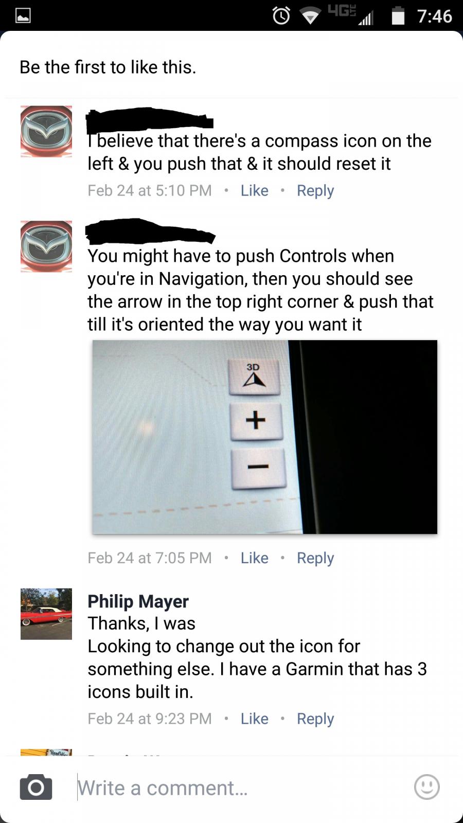

lildisco Posted March 30, 2017 Report Share Posted March 30, 2017 (edited) What does your screen say? Which way is north? You may have to push the compess on the screen to get it NOT to show map as North being up Edited March 30, 2017 by lildisco Quote Link to comment Share on other sites More sharing options...
MLTEdge Posted March 31, 2017 Report Share Posted March 31, 2017 On 3/30/2017 at 11:34 PM, lildisco said: What does your screen say? Which way is north? You may have to push the compess on the screen to get it NOT to show map as North being up I don't have nav. I'm referring to the bubble compass on the screen. When due North, it shows I'm pointed North, but that left would be East, and turning Right would be West. The needle is correct when going in the direction, but compass layout is backwards for East-West Quote Link to comment Share on other sites More sharing options...
akirby Posted March 31, 2017 Report Share Posted March 31, 2017 On 3/31/2017 at 12:21 PM, MLTEdge said: I don't have nav. I'm referring to the bubble compass on the screen. When due North, it shows I'm pointed North, but that left would be East, and turning Right would be West. The needle is correct when going in the direction, but compass layout is backwards for East-West It's normal and correct. If you look at an actual bubble compass the interior remains still while the outside rotates. So if you're facing North and you turn left (West), the indicator is actually moving towards the right (backwards). Quote Link to comment Share on other sites More sharing options...
MLTEdge Posted March 31, 2017 Report Share Posted March 31, 2017 On 3/31/2017 at 12:32 PM, akirby said: It's normal and correct. If you look at an actual bubble compass the interior remains still while the outside rotates. So if you're facing North and you turn left (West), the indicator is actually moving towards the right (backwards). Yea BACKWARDS! That's my contention. If you are going due N. Left is West, shows east. I agree it is correct in direction pointing while traveling, but is not correct as the dial of a compass. No other car I own shows left as East, no smartphone app, nor hand held compasses. I agree this is across all Edges, expect I haven't jumped into a 2017 yet to see. Quote Link to comment Share on other sites More sharing options...
