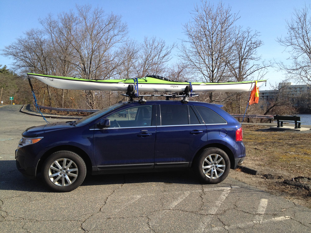

lou_s Posted June 4, 2012 Report Share Posted June 4, 2012 Hello everyone. Any long-term update on how this is working out (Yakima rack install with Q-towers and clips)? I am new to the Forum. Purchased a 2012 Edge Limited with BAMR a few weeks ago; so far so good. Coming off a 10-year relationship with a minivan, so I am very happy to have moved on. However, as the Edge is the “family vehicle”, I need some more space for long trips with the family and all our stuff. Searched the forum, found a few articles on how other’s who came before me dealt with this, and found this thread. Found some other suggestions as well, but I’m not willing to make any major modifications to my roof. Adding a Yakima with towers seemed like the best (only) real solution. Not to get detailed, I went ahead and bought these components and built the rack as described here (REI was having a sale). Tested it out with my rooftop box, and so far so good. Will be traveling with it in about two weeks. Just looking for some additional comments or advice from other’s who use this type of system. Thanks. -Lou. Quote Link to comment Share on other sites More sharing options...
rwolson Posted June 4, 2012 Report Share Posted June 4, 2012 I installed the Thule setup vs Yakima; I prefer rectangular bars to round bars. I transport an 18 foot kayak. I'm on year two using the system. The system works, but I still wish Ford installed real racks or a track. The reasons, rack's up a little more from the car's roof, I feel more secure to attach aftermarket roof racks to a real roof rack and I can spread the bars apart further to carry a kayak. The current configuration's very secure, but I just feel more secure when the rack's feet wrap around a roof rack. I maybe ordering a 2013 Escape later this year for the roof racks, etc. Quote Link to comment Share on other sites More sharing options...
lou_s Posted August 28, 2012 Report Share Posted August 28, 2012 Thought I would pass along an update to this tread should anyone be researching this issue. I went ahead and setup the Yakima system as described earlier in this post. My Edge is 2012 White with BAMR, so it looked identical to the pictures posted. I was using the rack for a rooftop box to carry extra cargo. Box was a medium size Yakima Rocketbox. Enough to carry soft-sided luggage and some bulky items. Rack took a while to setup, but I got it correct. Once I had it set, it was easy to get back on and off. Box is quick to put up as well. Now that it is configured, to put the whole thing up on the roof with the box and triple check takes about 30 minutes. So it went up relativity easy, and held the stuff I needed it to. Was on very secure, so I was not worried. Now the bad news. -Noise. Yes, it is a noticeable when the rack is on there; you can hear it. I may consider a wind deflector. -MPG. Don't know how accurate the Edge MPG computation is, but running the same trip (about 500 Miles round trip), MPG was down a bit. I know there are many factors that could cause this, but just an observation. -Scratches to the internal doorjamb where the rack sat. This is a big one, and makes me reluctant to put it on again. I was very meticulous in setting this up, using the included vinyl tape, following directions, etc. I even put down a few coats of car wax under where the clips go. However, there was some paint damage. So there you have it. Hope this helps. Quote Link to comment Share on other sites More sharing options...
