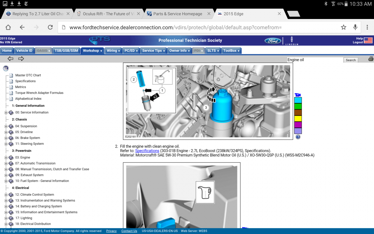

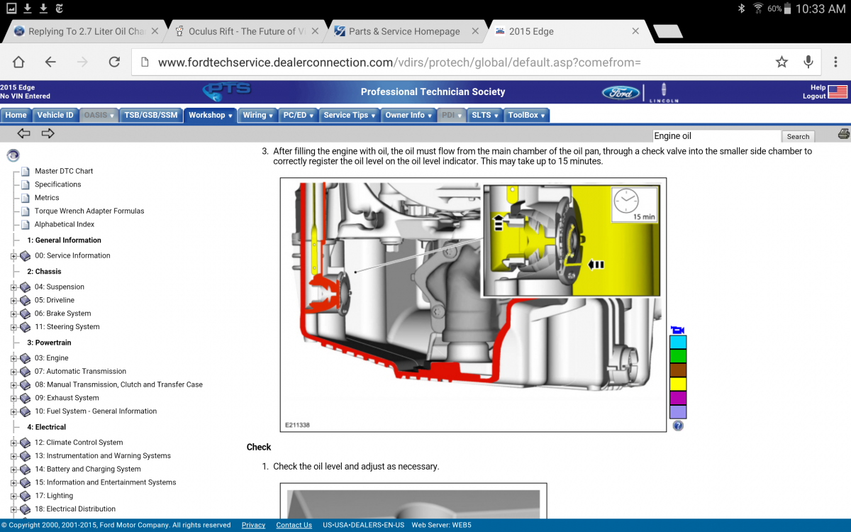

Reloaded Posted September 22, 2015 Report Share Posted September 22, 2015 Pretty much what has been posted. Sorry, last time I was able to save the procedure as a pdf file. 1 Quote Link to comment Share on other sites More sharing options...
Vadimus Posted September 22, 2015 Report Share Posted September 22, 2015 (edited) Your PDF baking skills are brilliant anyway, thanks, Reloaded! Edited September 22, 2015 by Vadimus Quote Link to comment Share on other sites More sharing options...

WingNut Posted September 23, 2015 Report Share Posted September 23, 2015 Love how the drain plug can be taken out without a wrench. I was reading other forums that talk about the 2.7L oil change and said the oil comes out pretty fast while draining so be prepared. Quote Link to comment Share on other sites More sharing options...
