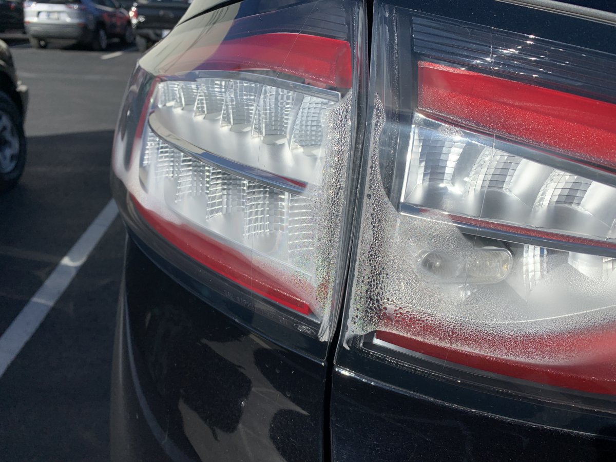

onyxbfly Posted October 2, 2019 Report Share Posted October 2, 2019 1 hour ago, Edgesport18 said: I have the same problem since new with all three , both tail lights and light bar on the tail gate ! Does anyone have a ruby red edge with pictures of condensation on the passenger side! They will not replace my passenger tail light without a picture of it with condensation! The pictures they had were lost in the system and I now have to wait for a rainy day to get a new picture ! Thank u in advance ! Are you kidding me.... wow thats awfully convenient of them.... 1 Quote Link to comment Share on other sites More sharing options...
akirby Posted October 2, 2019 Report Share Posted October 2, 2019 1 hour ago, Edgesport18 said: The pictures they had were lost in the system and I now have to wait for a rainy day to get a new picture ! Thank u in advance ! Car wash? Hose? 1 Quote Link to comment Share on other sites More sharing options...
Edgesport18 Posted October 3, 2019 Report Share Posted October 3, 2019 Ya well of course that’s not working now but it will eventually happen again I just didn’t want to wait forever to send the pictures to get my part ‘ Quote Link to comment Share on other sites More sharing options...
Gadgetjq Posted October 4, 2019 Report Share Posted October 4, 2019 On 10/2/2019 at 5:55 PM, Edgesport18 said: Ya well of course that’s not working now but it will eventually happen again I just didn’t want to wait forever to send the pictures to get my part ‘ Actually it sounds like the right side light is working as designed. As your manual tells you some condensation is normal and will eventually clear itself. What 'isn't normal are heavy droplets of water or a sloshing puddle in the bottom of the assembly. Perhaps only your left and center housings need replacement. Quote Link to comment Share on other sites More sharing options...

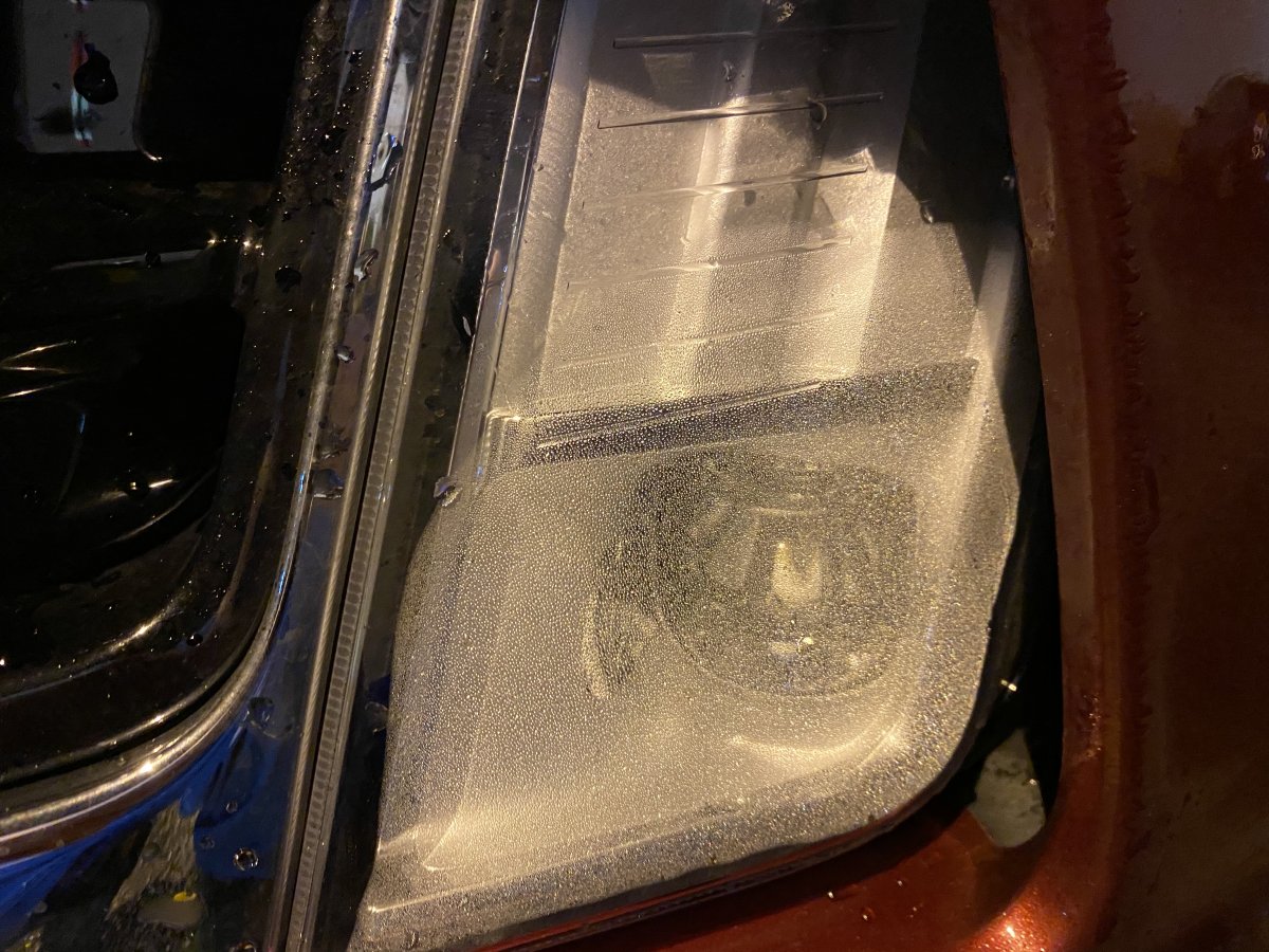

cleekoguy Posted November 2, 2019 Report Share Posted November 2, 2019 Well we've had this 2016 Edge for 10 days now. Getting tired of looking at the condensation in the tailgate light bar, like everyone else. And actually water puddles at each lower corner of the light bar. So today I used a 1/8 inch drill bit to put a hole at the left and right lower corners of the light bar. The water puddle came running out. Now I'll wait and see if the condensation dries up before it freezes in there next week as the cold weather hits us. G. Quote Link to comment Share on other sites More sharing options...
Gadgetjq Posted November 2, 2019 Report Share Posted November 2, 2019 Maybe you can help it along a little. I'm thinking a toilet paper tube taped over one of the holes then a hair dryer running on low and cool taped to the other end of the tube. Even a little airflow will help with evaporation. 1 Quote Link to comment Share on other sites More sharing options...

1004ron Posted January 6, 2020 Report Share Posted January 6, 2020 Noticed this on my 2017 Sport this morning for the first time. I have the extended Ford warranty that I paid $2K when purchased the car - what is Ford's response been to this, and will mine be covered? Quote Link to comment Share on other sites More sharing options...
onyxbfly Posted January 6, 2020 Report Share Posted January 6, 2020 Ford will say some nonsense that a lil condensation is to be expected due to the nature of lights etc. It should be covered if you have the full ESP that covers lights etc. That happened to my brother last year with his 2015 Sport. He brought his warranty post sale because he had additional coverage because it was a CPO. The dealer told him that his ESP did not cover lights and some other bits. The good thing is that the dealer said if you call up Budco (SP) they will upgrade it and he just had to pay the difference. He did it in the parking lot and the very next day the dealer processed the claim for him. Took about 3 weeks or so because the tail lights were on back order. He's been condensation free ever since. Quote Link to comment Share on other sites More sharing options...
1004ron Posted January 6, 2020 Report Share Posted January 6, 2020 1 hour ago, onyxbfly said: Ford will say some nonsense that a lil condensation is to be expected due to the nature of lights etc. It should be covered if you have the full ESP that covers lights etc. That happened to my brother last year with his 2015 Sport. He brought his warranty post sale because he had additional coverage because it was a CPO. The dealer told him that his ESP did not cover lights and some other bits. The good thing is that the dealer said if you call up Budco (SP) they will upgrade it and he just had to pay the difference. He did it in the parking lot and the very next day the dealer processed the claim for him. Took about 3 weeks or so because the tail lights were on back order. He's been condensation free ever since. Thanks, Just got a response from the service manager - I'll need to take care of it myself. I took it through the car wash on Saturday, and it remained in my garage until today (Monday) when I drove it to work - its cold today but no rain, just bright sunshine. The car wash uses a high pressure washer as a pre-wash, which they've done for all the years I taken it there - this came to mind and I'm now concerned about that, but don't understand why it hasn't been an issue until now. Quote I ran the part number and Oasis it is only covered under base warranty which is 3/36 you also did not have the lighting option on you ESP sometimes they cover under that. Quote Link to comment Share on other sites More sharing options...
onyxbfly Posted January 6, 2020 Report Share Posted January 6, 2020 2 minutes ago, 1004ron said: Thanks, Just got a response from the service manager - I'll need to take care of it myself. I took it through the car wash on Saturday, and it remained in my garage until today (Monday) when I drove it to work - its cold today but no rain, just bright sunshine. The car wash uses a high pressure washer as a pre-wash, which they've done for all the years I taken it there - this came to mind and I'm now concerned about that, but don't understand why it hasn't been an issue until now. Sorry to hear that. Hopefully it will clear up within the next few days. I don't think being parked indoors or not has anything to do with it. Perhaps park her outside overnight and see if that will help. There is no definitive rhyme or reason why it happens. It happened at my car wash once. As soon as I noticed it, I felt like I tasted throw up in my mouth. By time I got home it had cleared up. 1 Quote Link to comment Share on other sites More sharing options...
