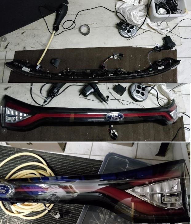

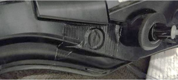

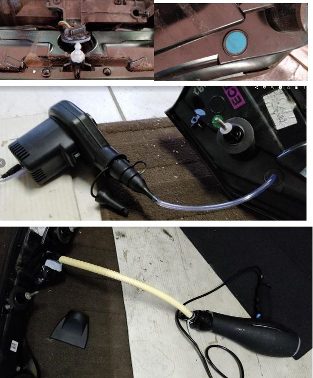

m__________d Posted August 17, 2018 Report Share Posted August 17, 2018 (edited) I have the same problem with my 2017 Edge which I bought last week (see top pictures below) I just joined this group today so I could share my findings.... I read all of your above posts (very informative)...but no known fix; dealers useless etc ... deep despair ... however ...Yesterday I removed the rear trim and the centre lamp assy and retreated to my workshop with it.On inspection the central (behind Ford badge) connector sealing cap was dettached and I 'think' this was the path in for moisture.In order to remove the moisture I peeled off 2x blue circular stickers which cover holes at either end of the assy and then blew air into each by rigging up-- i. an electrical inflation pump at one end and ii. the wife's hairdryer at the other (see pictures).The centre seal which i mentioned above was left off to allow the moist air to vent out.One hour of this and the lamp was clear of all moisture.I replaced the 2x blue stickers (they are crap) + some extra tape over them & then reassembled the lamp to the car -- in all 2hrs work -- time will tell if I need to do this again …. condensation.pdf Edited August 17, 2018 by m__________d 5 Quote Link to comment Share on other sites More sharing options...

enigma-2 Posted August 17, 2018 Report Share Posted August 17, 2018 (edited) Is it your opinion that the moisture is getting in though these stickers? Or if through the "vents", why not just dry out the lights and seal the vents with clear silicon sealant? Edited August 17, 2018 by enigma-2 1 Quote Link to comment Share on other sites More sharing options...
m__________d Posted August 20, 2018 Report Share Posted August 20, 2018 (edited) ...reporting back after my post 4 days ago. It didn't work. The night after my "fix" it rained heavily for a prolonged period of time and when I went out to the car in the morning the lamp was again full of condensation. Damn. Not one to be easily defeated off it came again and I gave it a good looking at...this time in very bright sunlight. I spotted something that I missed last time...2x pin holes drilled in the lower outboard corners at each end (see 1st picture). This is a rework according to me made by the supplier to Ford-- the lamp is marked with a date (june 2016) with a paint-pen which indicates to me the date of the rework. Also the welding of the lens to the body of the lamp appeared to be incomplete in areas--I think this is the root-cause of the problem...a supplier quality issue...the drilled holes are the half-arsed attempt to let that moisture out. Never gunna work (would love to see the 8D for that)! So... I again got the condensation out using the same method as before. And then went on to seal the complete lamp up with black silicon (@enigma-2 we're on the same wavelength I think). I completely sealed it all round (pics attached) and replaced the blue stickers with something more substantial. After I had done this I took the car for a jet-wash and whilst I went easy around the lamp there was later evidence of condensation again. This could be some residual stuff from before my rework and it went away after a bit of sun. I'm keeping an eye on this....but in any case I don't know what to do next if its still not fixed. As an aside I relocated the rubber seal between the lamp and the screen. Having looked at it I do not believe it was designed to be fitted under-flush to the lamp/screen assy. The profile suggests it should be fitted the way I have (again a pic below). Debatable whether it looks worse than the original build...but it will certainly keep more moisture away like this. Edited August 20, 2018 by m__________d 1 Quote Link to comment Share on other sites More sharing options...
