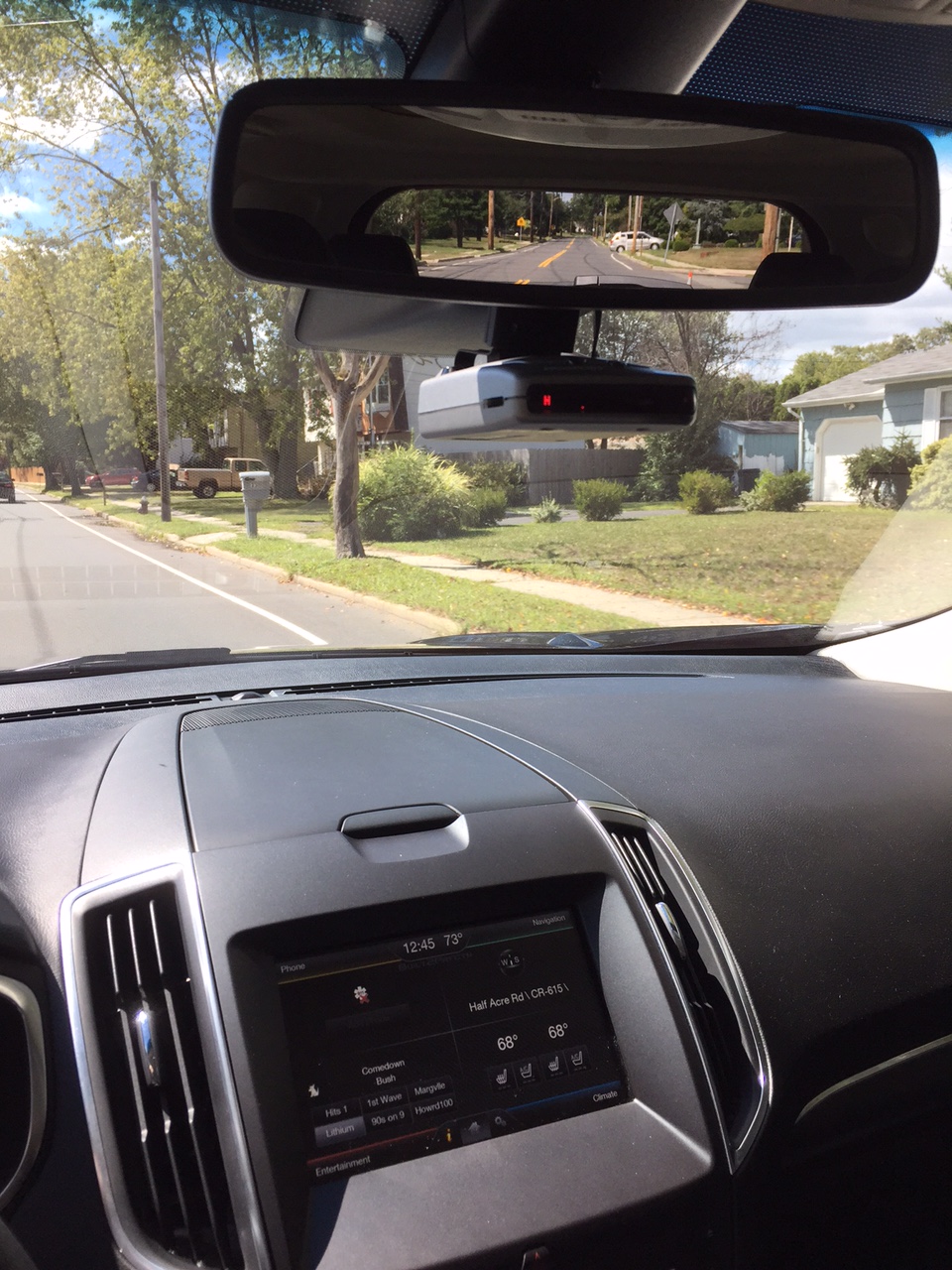

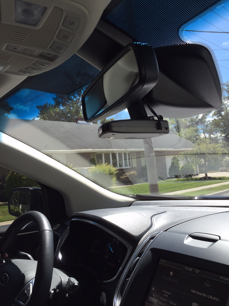

built2prfctn Posted September 11, 2015 Report Share Posted September 11, 2015 So I finally completed this. I tap into the white plug behind the mirror. Green wire is hot - brown is ground. 4 Quote Link to comment Share on other sites More sharing options...

Colt Posted September 23, 2015 Report Share Posted September 23, 2015 Nice work, thanks for sharing! Quote Link to comment Share on other sites More sharing options...
Excelongt Posted February 11, 2016 Report Share Posted February 11, 2016 clean install. are you using a "blendmount" or something else? Quote Link to comment Share on other sites More sharing options...

enigma-2 Posted February 14, 2016 Report Share Posted February 14, 2016 So I finally completed this. I tap into the white plug behind the mirror. Green wire is hot - brown is ground.Nice! What do you think about Escort Live? Kind of interesting to see a radar hit pop up from another driver from another part of the driving area, isn't it? What did you go with for the mount? (I'm running the Max and decided to stay with the standard mount. It looks like you went with the Blend mount). Quote Link to comment Share on other sites More sharing options...
