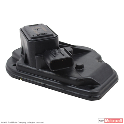

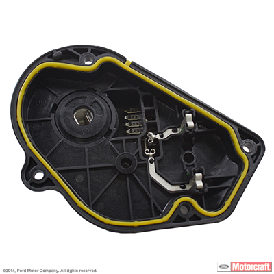

WWWPerfA_ZN0W Posted September 8, 2015 Report Share Posted September 8, 2015 (edited) Cannot be cleaned, needs to be replaced, as it is an electronic failure in the TB controller triggering the "failsafe". The electronic part (potentiometer) is available separately for the 2007-2010 9T4Z-9B989-A, unfortunately I do not see one for the 2011+ (maybe it's called something else?). You could try MAF/electronics cleaner on it in case it IS just dirt buildup (like the door latches). No way to provide evidence one way or the other on a working TB, unfortunately. But a clean TB will behave like it is told to, at least! EDIT: As far as I can confirm, 2011+ potentiometers/throttle body sensors for the 3.5L are part number 9T4Z-9B989-B, or Motorcraft DY-1286. http://www.fordparts.com/Commerce/PartDetail.aspx?n=IAhDc0KM68Y9KaulEbOtnw%3d%3d&id=327309175&m=44&search=true Images may not be the exact part, but give you an idea: Edited September 8, 2015 by WWWPerfA_ZN0W 1 Quote Link to comment Share on other sites More sharing options...
