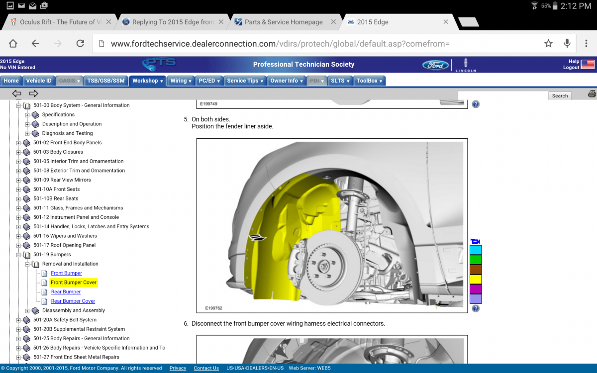

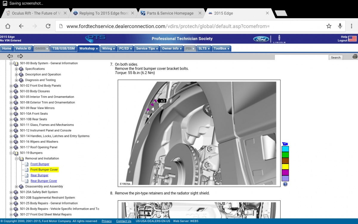

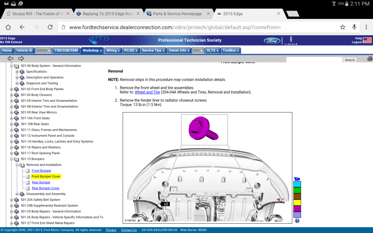

Reloaded Posted September 3, 2015 Report Share Posted September 3, 2015 Here's the Ford workshop manual on the subject. Good luck. Sorry about the pics; this site is blocked at work and I can't access the manual fom my tablet. Quote Link to comment Share on other sites More sharing options...

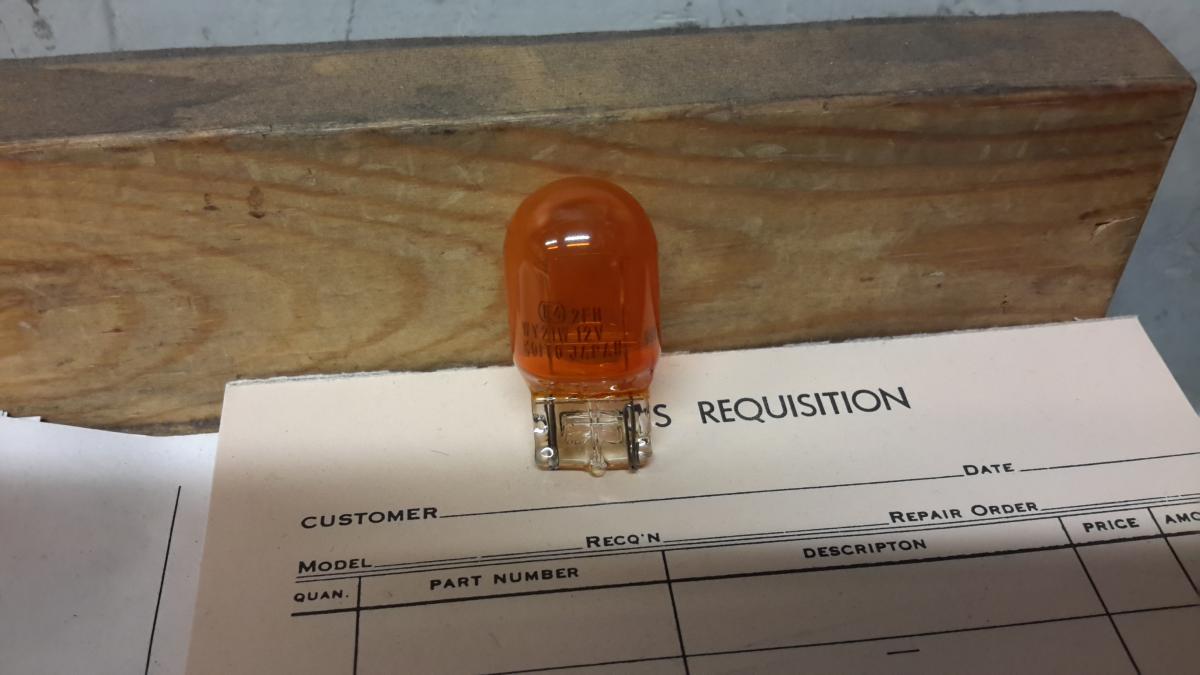

Reloaded Posted September 3, 2015 Report Share Posted September 3, 2015 Ford part number is 5N2Z.13466.A Here's a pic of the bulb. WY21W maybe? Quote Link to comment Share on other sites More sharing options...

joedrum71 Posted September 3, 2015 Author Report Share Posted September 3, 2015 Np. Have fun with the bumper! :P Hmmm... I just looked at that on your pic. I totally skipped the "remove front bumper cover" part. You don't have screen shot of how to get that off, do you? Quote Link to comment Share on other sites More sharing options...

Reloaded Posted September 3, 2015 Report Share Posted September 3, 2015 Hmmm... I just looked at that on your pic. I totally skipped the "remove front bumper cover" part. You don't have screen shot of how to get that off, do you? Yeah I have access to it. It's 11 steps, so I should probably do it when I get home and get a proper screenshot. Be a mess taking pics via my tablet. I'll see if I can access the manual from here. 1 Quote Link to comment Share on other sites More sharing options...
joedrum71 Posted September 3, 2015 Author Report Share Posted September 3, 2015 Yeah I have access to it. It's 11 steps, so I should probably do it when I get home and get a proper screenshot. Be a mess taking pics via my tablet. I'll see if I can access the manual from here. OK. Thanks! Quote Link to comment Share on other sites More sharing options...
Reloaded Posted September 3, 2015 Report Share Posted September 3, 2015 1 last pic to post 1 Quote Link to comment Share on other sites More sharing options...
Reloaded Posted September 3, 2015 Report Share Posted September 3, 2015 Sorry about all the screenshots, but it's the best I can do since I can't download the whole page. Hope it helps. 2 Quote Link to comment Share on other sites More sharing options...

joedrum71 Posted September 4, 2015 Author Report Share Posted September 4, 2015 Holy. Balls. Just to change a stinkin' bulb? Is this seriously the only way to get at it? My guess? I'll leave the bulbs in till I absolutley HAVE to replace a bulb. The thing that sucks is that I can almost reach the driver's side, but it's just out of reach. Thanks everybody for the help/guides. Quote Link to comment Share on other sites More sharing options...
