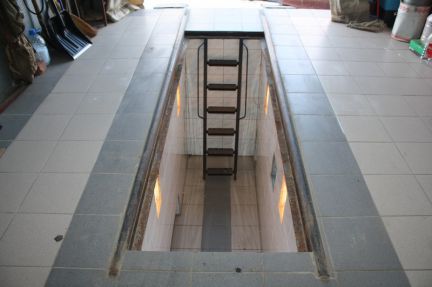

EDST777 Posted September 4, 2015 Author Report Share Posted September 4, 2015 Friends. Physically the sensors TSS and OSS pro-wolves are a piece, and at first sight there is nothing to break, therefore at me as well as at many other people a question, why they such problem, in what a problem of their breakage and a failure in a transmission (wires are damaged, become covered by waste of oil or still something)? Somebody can give the comment. Thanks. Quote Link to comment Share on other sites More sharing options...
WWWPerfA_ZN0W Posted September 4, 2015 Report Share Posted September 4, 2015 By "repair hole" you mean a pit like the quick lube places (Jiffy Lube, Grease Monkey, etc.)? Yeah, that'd work fine. As to why the sensors fail, no idea. Though frankly, I'd rather replace sensors than power/drivetrains. In time/money terms these days, the same thing? Who knows what's better. Ā I'd suspect (no basis to make this statement) that regular trans fluid changes (36K miles or max of 60K miles) would help keep the sensors working. Electronics are very sensitive to contamination, and probably what is happening here. 1 Quote Link to comment Share on other sites More sharing options...

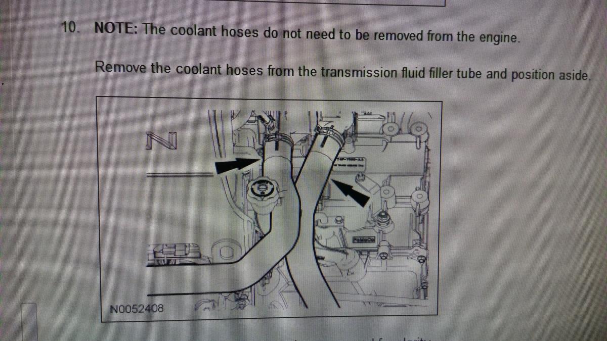

EDST777 Posted September 6, 2015 Author Report Share Posted September 6, 2015 (edited) Friends, when replacing the OSS sensor in procedure (a step 10) it is specified: NOTE: The coolant hoses do not need to be removed from the engine. Remove the coolant hoses from the transmission fluid filler tube and position aside. Whether my question: needs to be deleted cooling liquid? I think to pump out through a broad tank before separating hoses which are specified on the image. What your opinion? Edited September 6, 2015 by EDST777 Quote Link to comment Share on other sites More sharing options...
