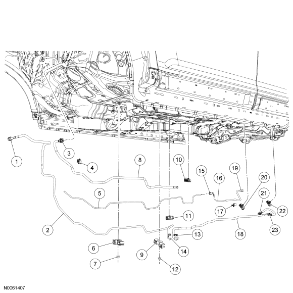

WWWPerfA_ZN0W Posted August 8, 2015 Report Share Posted August 8, 2015 (edited) Someone had posted that there are a few small holes around the gas filler neck. Blowing compressed air into these holes should blow out the vent tube. If it doesn't seem to be a lasting solution, you could get underneath the vehicle, disconnect the coupler and blow it out from there. Info below is for a 2007 Edge, hopefully the 2011 is similar: Item Part Number Description 1 — Evaporative emission (EVAP) outlet tube-to-purge valve quick connect coupling (part of 9S284) 2 9D661A EVAP emission purge valve output tube 3 — Fresh air tube-to-vent tube quick connect coupling (part of 9S284) 4 9F931 Bundle retainer clip 5 9S284 Fuel supply tube 6 9F931 Bundle retainer clip 7 W707137 Bundle retainer clip nut 8 9S284 Fresh air tube 9 9F931 Bundle retainer clip 10 9F931 Bundle retainer clip 11 9F931 Bundle retainer clip 12 W707137 Bundle retainer clip nut 13 — Fuel vapor tube assembly-to-EVAP canister quick connect coupling (part of 9S284) 14 — EVAP purge valve outlet-to-EVAP canister quick connect coupling (part of 9S284) 15 — Fuel tank supply tube-to-fuel supply tube quick connect coupling (part of 9324) 16 9324 Fuel tank supply tube 17 9F931 Bundle retainer clip 18 9S284 Fuel vapor tube assembly 19 — Fuel tank supply tube-to-fuel pump module quick connect coupling (part of 9324) 20 9F931 Bundle retainer clip 21 — Fuel vapor tube assembly-to-fuel tank quick connect coupling (part of 9S284) 22 9F931 Bundle retainer clip 23 9G611 Fuel tank pressure transducer (FTPT) (part of 9S284) Disconnect the fresh air tube-to-vent hose quick connect coupling. Edited August 8, 2015 by WWWPerfA_ZN0W Quote Link to comment Share on other sites More sharing options...
fletcher Posted August 8, 2015 Author Report Share Posted August 8, 2015 Someone had posted that there are a few small holes around the gas filler neck. Blowing compressed air into these holes should blow out the vent tube. If it doesn't seem to be a lasting solution, you could get underneath the vehicle, disconnect the coupler and blow it out from there. Info below is for a 2007 Edge, hopefully the 2011 is similar: 2007 Edge Fuel Lines.gif Item Part Number Description 1 — Evaporative emission (EVAP) outlet tube-to-purge valve quick connect coupling (part of 9S284) 2 9D661A EVAP emission purge valve output tube 3 — Fresh air tube-to-vent tube quick connect coupling (part of 9S284) 4 9F931 Bundle retainer clip 5 9S284 Fuel supply tube 6 9F931 Bundle retainer clip 7 W707137 Bundle retainer clip nut 8 9S284 Fresh air tube 9 9F931 Bundle retainer clip 10 9F931 Bundle retainer clip 11 9F931 Bundle retainer clip 12 W707137 Bundle retainer clip nut 13 — Fuel vapor tube assembly-to-EVAP canister quick connect coupling (part of 9S284) 14 — EVAP purge valve outlet-to-EVAP canister quick connect coupling (part of 9S284) 15 — Fuel tank supply tube-to-fuel supply tube quick connect coupling (part of 9324) 16 9324 Fuel tank supply tube 17 9F931 Bundle retainer clip 18 9S284 Fuel vapor tube assembly 19 — Fuel tank supply tube-to-fuel pump module quick connect coupling (part of 9324) 20 9F931 Bundle retainer clip 21 — Fuel vapor tube assembly-to-fuel tank quick connect coupling (part of 9S284) 22 9F931 Bundle retainer clip 23 9G611 Fuel tank pressure transducer (FTPT) (part of 9S284) 2007 Edge fresh air tube-to-vent hose quick connect coupling.gif Disconnect the fresh air tube-to-vent hose quick connect coupling. 2007 Edge quick connect coupling type I.gif 2007 Edge quick connect coupling type 2.gif 2007 Edge quick connect coupling type 3.gif 2007 Edge quick connect coupling type 4.gif 2007 Edge quick connect coupling type 5.gif 2007 Edge quick connect coupling type 6.gif Thanks for all the info. I'll give it a try. Quote Link to comment Share on other sites More sharing options...
