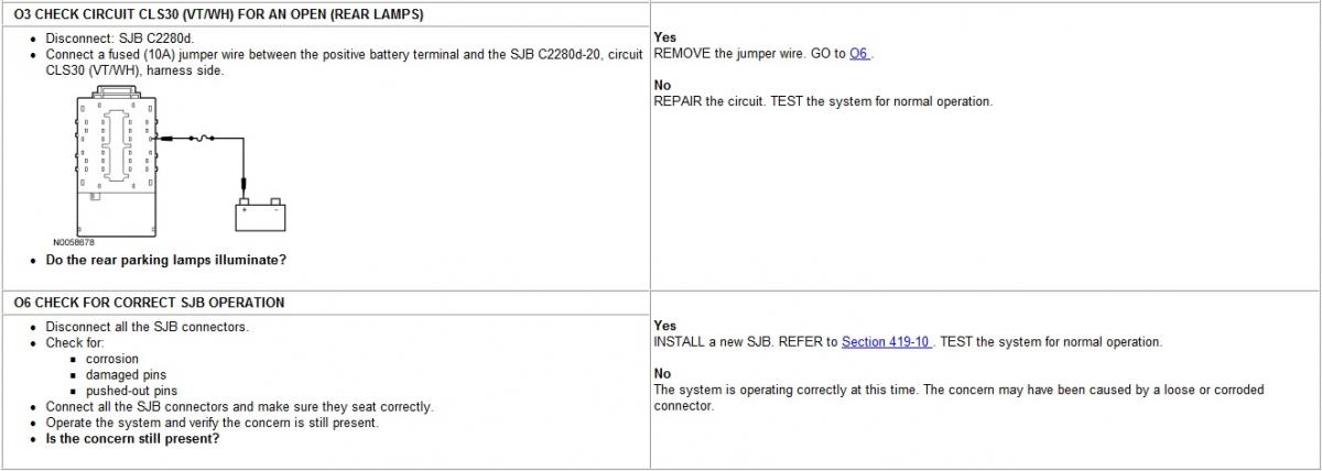

WWWPerfA_ZN0W Posted August 2, 2015 Report Share Posted August 2, 2015 There might be an issue with the SJB (smart junction box) - short in wiring ... Quote Link to comment Share on other sites More sharing options...
