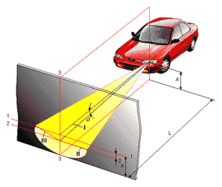

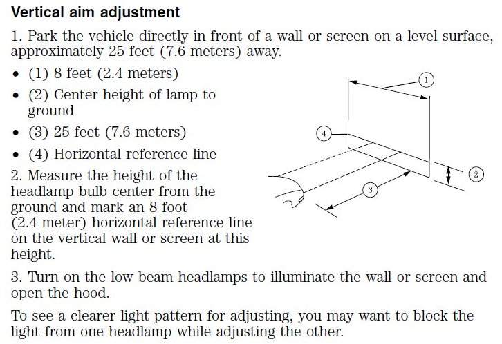

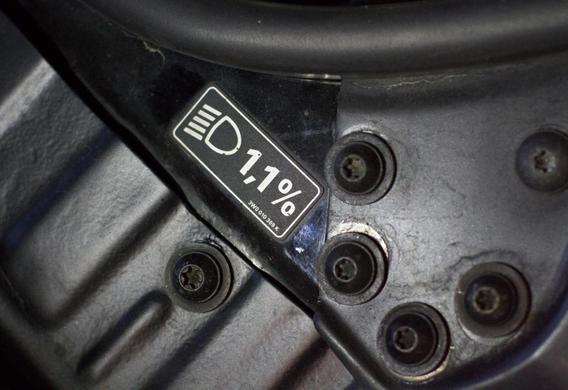

EDST777 Posted August 2, 2015 Report Share Posted August 2, 2015 (edited) Hello. In the user guide it is possible to read as correctly to adjust headlights (you watch the image ). This image is attached to all Ford models, but it is strange that descent angles of light of headlights aren't specified anywhere. Usually it is specified on the block headlight as a percentage, but on my car I couldn't find such data. It is correct, on on Ford EDGE 2008 (the angle of incidence lights)descent angle of light of headlights of 0%? Any thoughts. Edited August 2, 2015 by EDST777 Quote Link to comment Share on other sites More sharing options...
EDST777 Posted August 2, 2015 Author Report Share Posted August 2, 2015 (edited) Somebody knows what Wal an Alpha on Ford EDGE 2008? Edited August 2, 2015 by EDST777 Quote Link to comment Share on other sites More sharing options...
candurin Posted August 2, 2015 Report Share Posted August 2, 2015 What are you trying to accomplish? The manual should have a distance and pattern the headlights should be adjusted to. If you're going for NIST calibrated accuracy, it may be a bit overkill. Quote Link to comment Share on other sites More sharing options...
EDST777 Posted August 2, 2015 Author Report Share Posted August 2, 2015 (edited) What are you trying to accomplish? The manual should have a distance and pattern the headlights should be adjusted to. If you're going for NIST calibrated accuracy, it may be a bit overkill. I want to adjust headlights, but to me it is strange that the descent angle of a luminous flux to the earth as a percentage isn't specified, on all other cars it is present. It is specified as a percentage meter.Look for Alf's angle on the image. Edited August 2, 2015 by EDST777 Quote Link to comment Share on other sites More sharing options...
