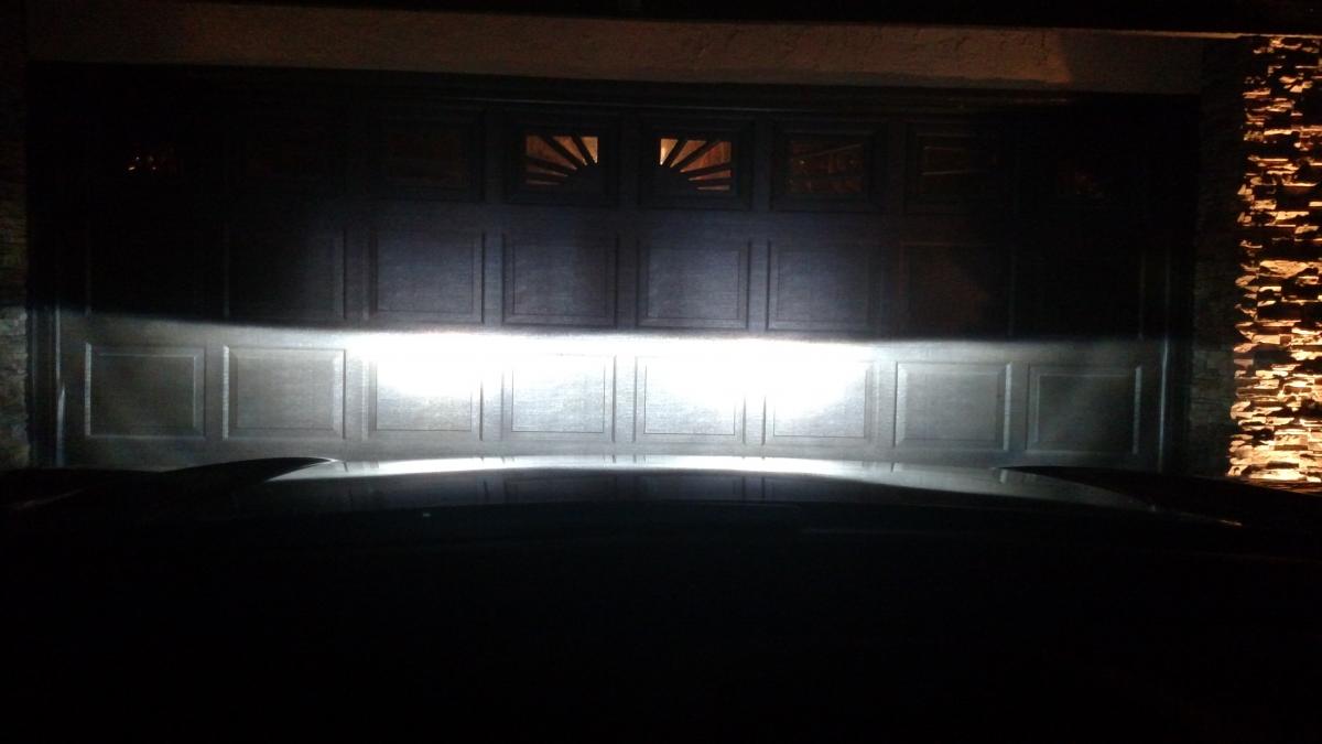

s4tom3 Posted July 16, 2015 Report Share Posted July 16, 2015 As promised I have finally completed installation of my new DDM Tuning HID conversion. What a huge difference it has made over the pathetic stock halogens. ZERO PROMBLEMS!! Ordered the complete kit from DDM Tuning who happens to be located in San Diego. They said to go with their new Ultra Canbus HID Kit. http://www.ddmtuning.com/Products/UltraCanbusHID. I went with the 5500k bulbs and they work amazing. They do have a slight hue of blue and are very bright. They fire up immediately with no apparent warm up. More in line with the new lighting systems on BMW, Audi and Mercedes. The cost was very reasonable at $119.95. Had the shop next door do a custom install for $120. A lot of improvement for the money. And best of all LIFETIME WARRANTY ON BULBS AND BALLASTS!! Can't beat that. Quote Link to comment Share on other sites More sharing options...

ducrider Posted July 18, 2015 Report Share Posted July 18, 2015 Any thoughts you may be blinding oncoming drivers? Quote Link to comment Share on other sites More sharing options...
s4tom3 Posted July 19, 2015 Author Report Share Posted July 19, 2015 Don't think it is an issue. I compared light cut off on my garage door before and after. They look like they are exactly the same. Bulb position did not change. No one flashing their brights at me. Just much better lighting over halogens. Quote Link to comment Share on other sites More sharing options...

Denicio Posted February 10, 2016 Report Share Posted February 10, 2016 My recent upgrade to HID lights has caused several drivers to flash me with their brights. Can the lights be adjusted? Quote Link to comment Share on other sites More sharing options...
Nick Halstead Posted February 11, 2016 Report Share Posted February 11, 2016 My recent upgrade to HID lights has caused several drivers to flash me with their brights. Can the lights be adjusted? No, by aiming the lights lower, you decrease the amount of usable light the driver of the vehicle has. Oncoming traffic will always be blinded by your lights because you have HIDs in a housing that was designed to reflect halogen bulbs. 1 Quote Link to comment Share on other sites More sharing options...
