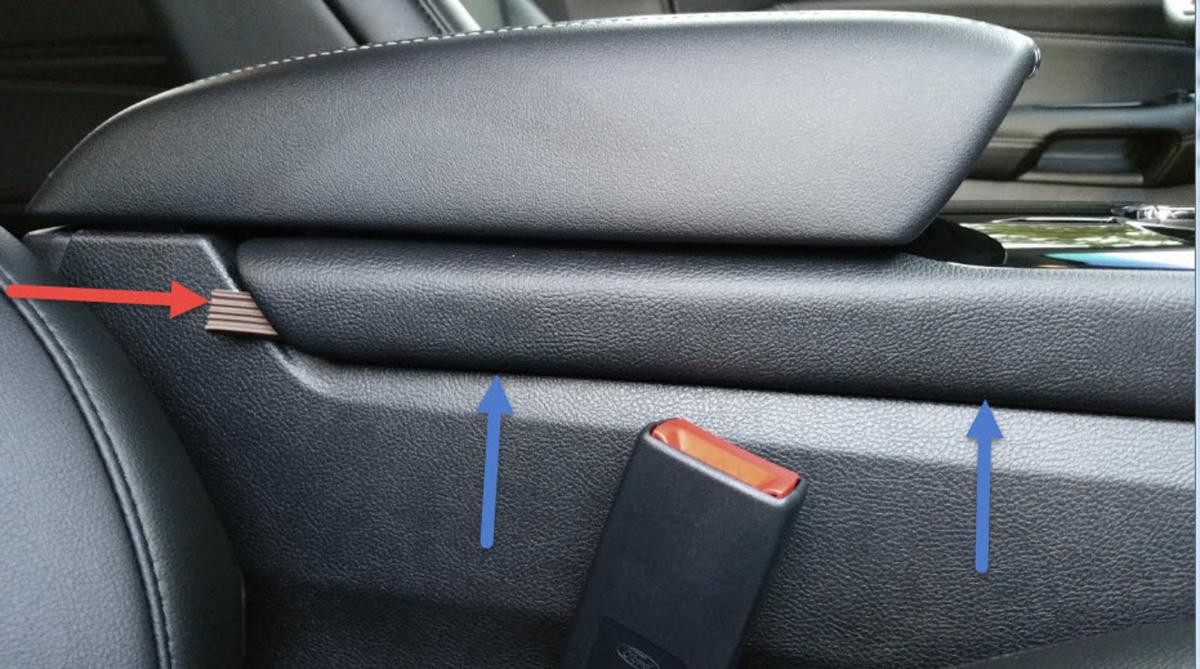

stevews99 Posted July 19, 2015 Report Share Posted July 19, 2015 (edited) I had a rattle that was difficult to locate in the same general area you described. It turned out to be the plastic trim on the top edge of the center console (passenger side). If you want to check and see if this is the issue you can press on the trim when you are driving and see if the noise changes or is gone. Once you verify the trim is the problem, move the passenger seat all the way back and recline fully you can see the curved edge of the trim just below the top of the center console (towards the back). The trim is attached to the console with plastic tabs and it's pretty easy to remove is by pulling gently from the back (be careful!). I placed some door weatherstripping (foam with a sticky backing) on the console along the lower edge where the trim is located and reattached the trim. You may have to push a little harder to get the trim to click into the tab which is good because that means the weatherstripping is cushioning the plastic trim. This fix completely eliminated the rattle and squeak! My next task is to attack the rattle coming from the plastic covers on the rear seat belts. If anyone has a fix I appreciate the info! Be well... Edited July 19, 2015 by stevews99 Quote Link to comment Share on other sites More sharing options...
stevews99 Posted July 19, 2015 Report Share Posted July 19, 2015 You don't have to remove the entire trim strip which runs along the side of the console. From the back I removed about 6 inches of trim and installed the weatherstripping which did the trick. 1 Quote Link to comment Share on other sites More sharing options...

Chris Miller Posted August 6, 2015 Report Share Posted August 6, 2015 I second the request of anyone would be kind enough to post pictures of where to pull up and what kind of materials used to remedy this creaking Quote Link to comment Share on other sites More sharing options...
Norm J Posted September 16, 2015 Report Share Posted September 16, 2015 I had a rattle that was difficult to locate in the same general area you described. It turned out to be the plastic trim on the top edge of the center console (passenger side). If you want to check and see if this is the issue you can press on the trim when you are driving and see if the noise changes or is gone. Once you verify the trim is the problem, move the passenger seat all the way back and recline fully you can see the curved edge of the trim just below the top of the center console (towards the back). The trim is attached to the console with plastic tabs and it's pretty easy to remove is by pulling gently from the back (be careful!). I placed some door weatherstripping (foam with a sticky backing) on the console along the lower edge where the trim is located and reattached the trim. You may have to push a little harder to get the trim to click into the tab which is good because that means the weatherstripping is cushioning the plastic trim. This fix completely eliminated the rattle and squeak! My next task is to attack the rattle coming from the plastic covers on the rear seat belts. If anyone has a fix I appreciate the info! Be well... Any chance of somebody posting a picture with the trim off and how and where to place the weatherstripping? This noise is so annoying. -- Thanks. Quote Link to comment Share on other sites More sharing options...
stevews99 Posted September 22, 2015 Report Share Posted September 22, 2015 Norm and others: I understand how annoying the rattle from the console area can be! I hope the information I am providing will help. The photo below was take on the passenger side of the Edge. The passenger seat was moved as far back as possible and fully reclined. The red arrow points to the spot where you can pry the plastic trim off the side of the console. PLEASE be careful! I used a screwdriver and gently popped the trim fastener out of the hole on the console. Once you get the pointed edge of the trim out you can easily (and gently!) pull the trim off. The blue arrows point to the edge of the trim piece where I inserted the door weather stripping. I attached the adhesive side to the console along the edge of the trim. You can see some of the weather stripping extending from the edge of the trim. Cut this off when you are done. You don't need to do the entire trim piece. I stopped about where the second blue arrow is located. When you replace the trim piece just pop the fasteners back into the holes in the console. You might have to push a little...that's good! It means the weather stripping is tight against the edge of the trim. 1 Quote Link to comment Share on other sites More sharing options...
