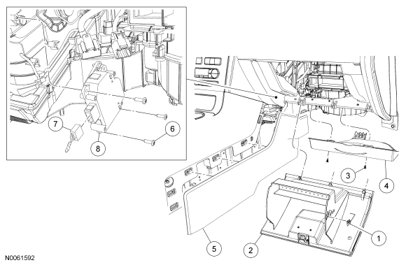

WWWPerfA_ZN0W Posted July 9, 2015 Report Share Posted July 9, 2015 (edited) Typically these sounds in a Ford will indicate blend door actuator failure, and can happen with climate control on/off. I looked at these instructions from the 2007 FSM, probably not too different from the 2014 setup: Item Part Number Description 1 7806200 Glove compartment damper 2 7806024 Glove compartment 3 — RH lower instrument panel insulator pin-type retainer (2 required) 4 — RH lower instrument panel insulator 5 7804608 RH lower floor console trim panel 6 — RH temperature blend door actuator screw (3 required) 7 19C603 RH temperature blend door actuator electrical connector 8 19E616 RH temperature blend door actuator Removal and Installation NOTE: It is not required to install the new RH temperature blend door linkage parts included in the RH temperature blend door actuator service part kit if only the temperature blend door actuator requires replacement and the linkage parts are not broken or binding. RH temperature blend door actuator and linkage Disconnect the glove compartment damper from the glove compartment.Remove the glove compartment.Remove the RH lower instrument panel insulator.Remove the RH lower floor console trim panel.Remove the 3 RH temperature blend door actuator screws.Disconnect the RH temperature blend door actuator electrical connector.Remove the RH temperature blend door actuator.Manually operate, and inspect the RH temperature blend door linkage for incorrect placement, binding or damage.RH temperature blend door actuator linkage only Detach the 2 retaining tabs and remove the RH temperature blend door linkage. All vehicles To install, reverse the removal procedure. BTW, welcome to the forum! Edited July 9, 2015 by WWWPerfA_ZN0W Quote Link to comment Share on other sites More sharing options...
