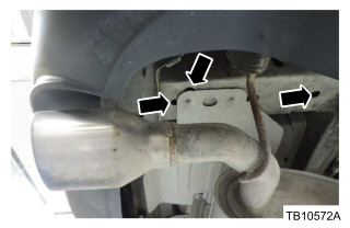

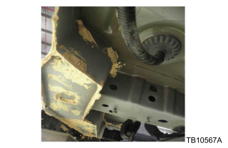

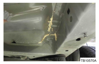

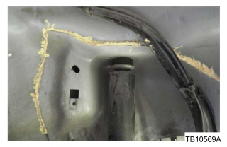

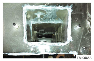

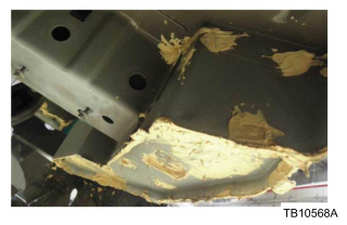

4.Clean the areas on the underside of vehicle where seam sealer and expandable foam will be applied. (Figures 1-6)
5.Cover the exhaust system.
6.Apply a generous amount of Motorcraft® Seam Sealer to the rear horizontal sheet metal lap joints on the left and right sides of the vehicle and the rear sheet metal overlap flange across the rear of the vehicle. (Figures 1-6)
Figure 1 – 14-0201
Figure 2 - 14-0201
Figure 3 - 14-0201
Figure 4 - 14-0201
Figure 5 - 14-0201
Figure 6 - 14-0201
Figure 7 - 14-0201

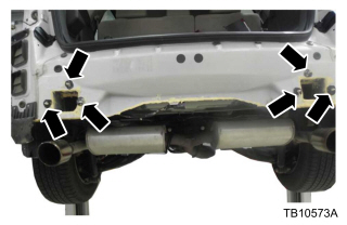

7.Fill crush cans with Lord Fusor 130 or 3M 08458 expandable foam. Follow the instructions on the can for application. (Figure 7)
8.Install foam from the Rotunda Squeak and Rattle Repair Kit (164-R4901) around the bumper beam attachment studs. (Figure 8)
Figure 8 – 14-0201
a.Some vehicle configurations may have unused bumper attachment studs on each side of the vehicle. Apply Motorcraft Seam Sealer around unused studs. (Figure 8)

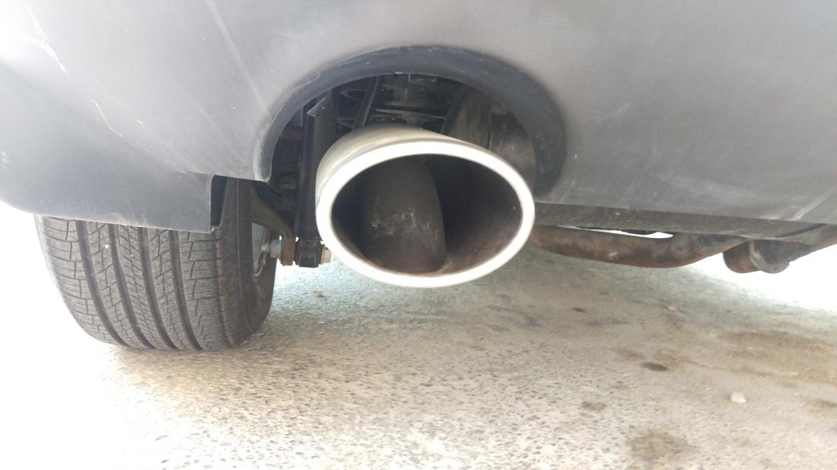

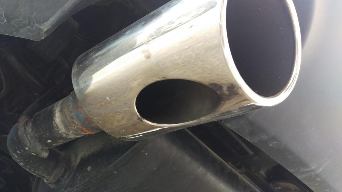

2. Inform the customer of the redesigned exhaust tips and that appearance will remain the same but the exhaust will exit the tip from bottom. Upon acceptance, replace the muffler assembly with the updated part containing the down turned exhaust tips. (Figures 7-8)
exhaust tips Figure 7
Explorer%20Exhaust%20Smell%20Fig7_zpsvc9
exhaust tips Figure 8
Explorer%20Exhaust%20Smell%20Fig8_zpsv6u
