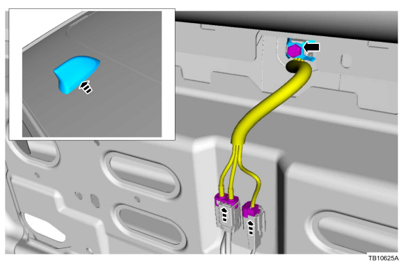

3.Remove both C-pillar trim panels. Refer to WSM, Section 501-05.
4.Remove both rear grab handles.
5.Starting from the rear of the vehicle release the pushpins and magnets from the liftgate opening to the grab handle mounting location, to allow access to the antenna.
6.Replace the audio unit antenna.
a.Remove the retainer and audio unit antenna and harness through the roof opening. (Figure 1)
b.The new audio unit antenna must be painted to the vehicle color before installing.
c.Tighten the bolt to 7 Nm (62 lb-in.).
7.To install, reverse the removal procedure.
