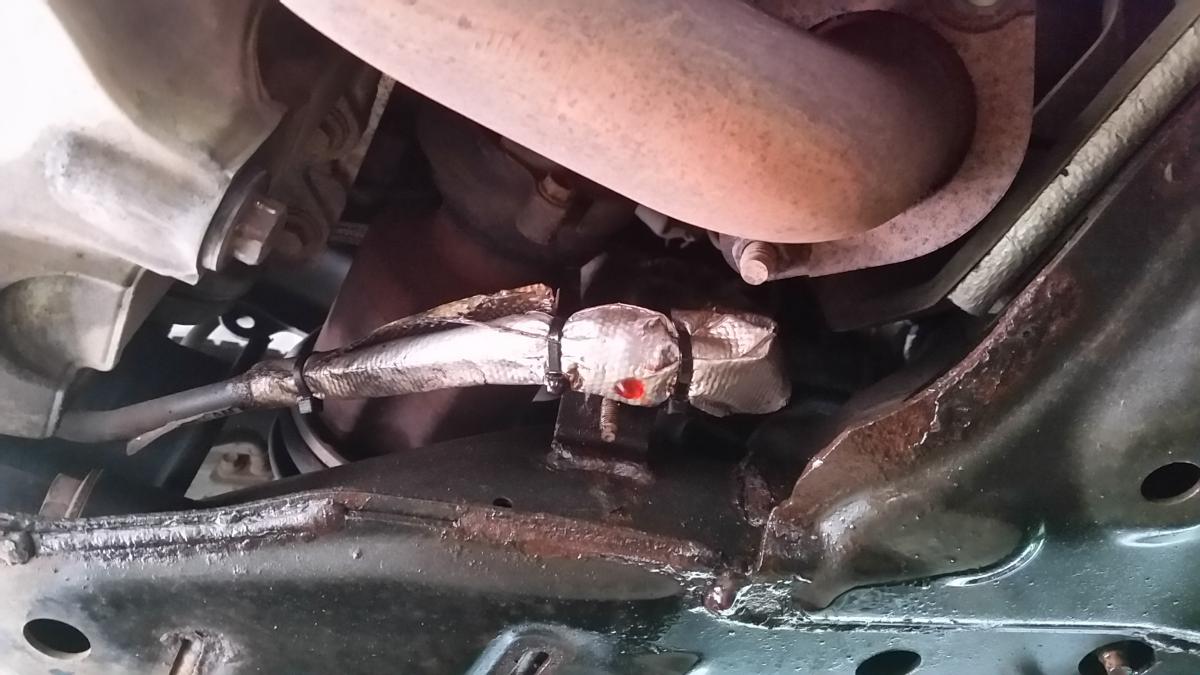

Robw13 Posted July 24, 2016 Report Share Posted July 24, 2016 Here's some pics of the Line in question. It does have a bend in it but doesn't have the rounded ends like the pic above. Quote Link to comment Share on other sites More sharing options...
Bilzfan29 Posted September 28, 2016 Report Share Posted September 28, 2016 Any fix to this problem? I can't find the replacement part number. I can see 7t43-3a563-am on the line that is leaking. It's gotta be a return line with just a clamp holding it. Quote Link to comment Share on other sites More sharing options...
