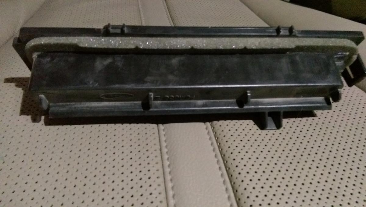

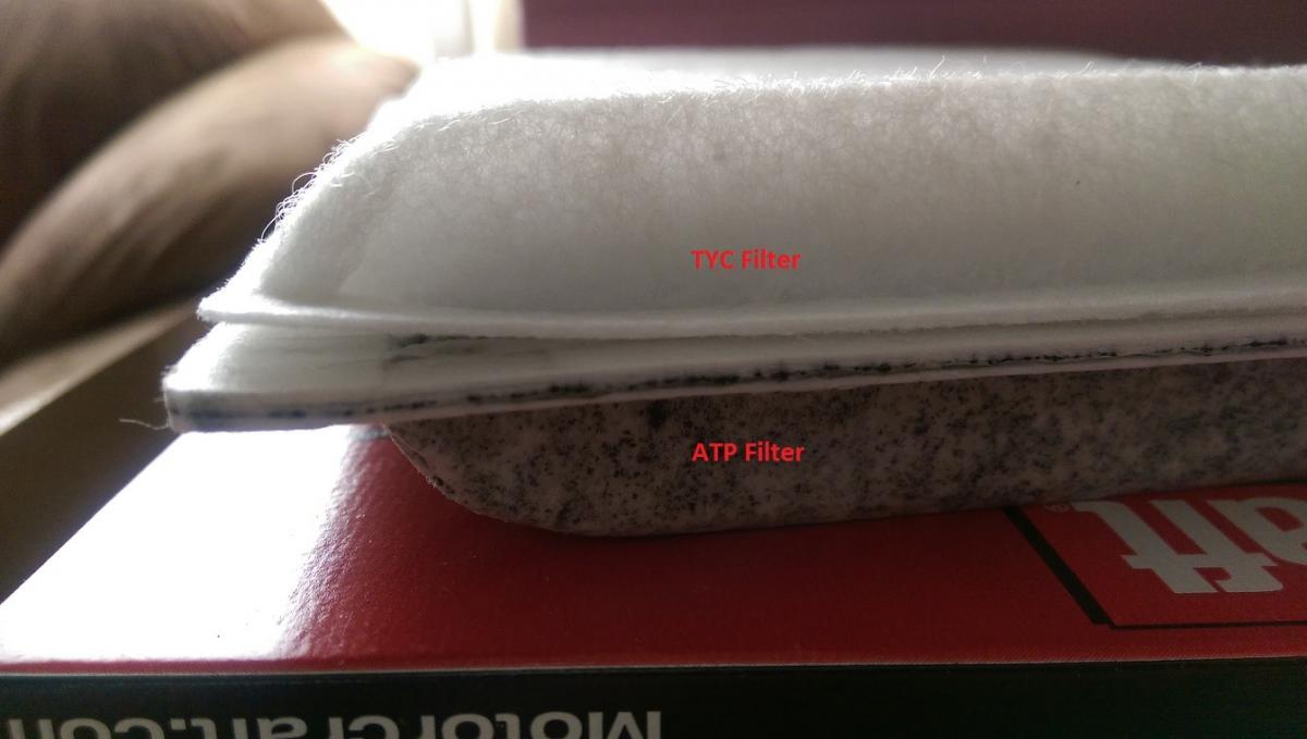

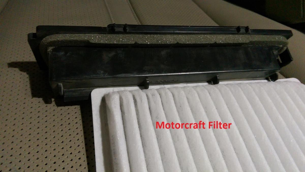

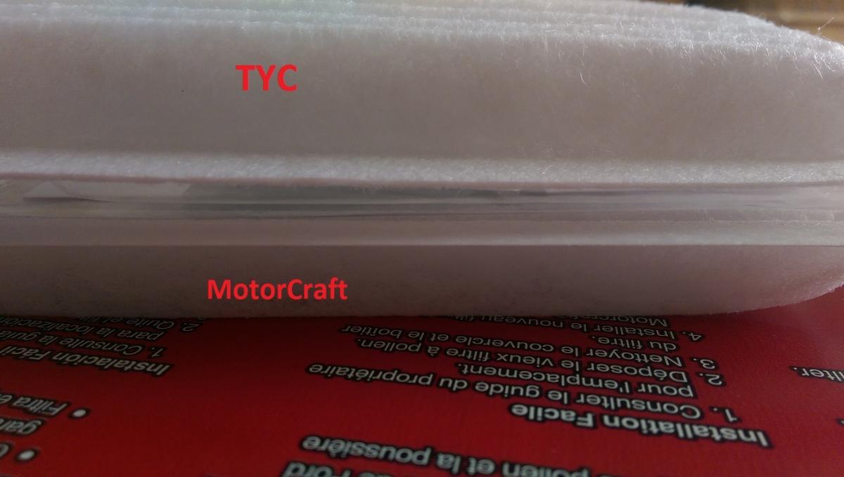

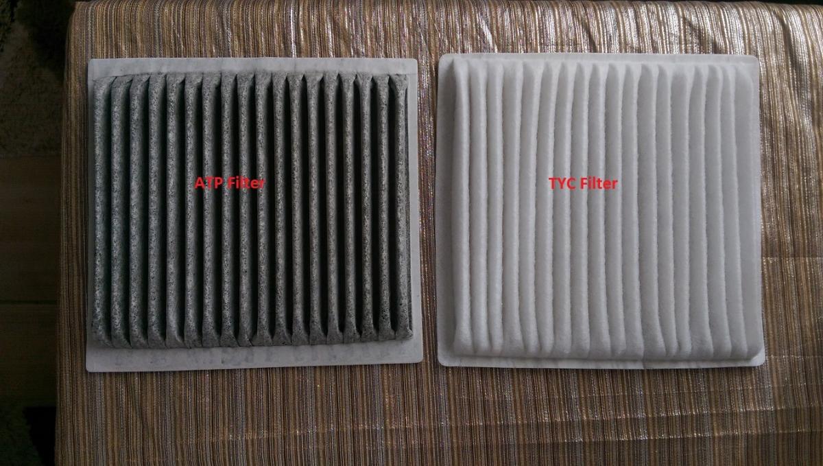

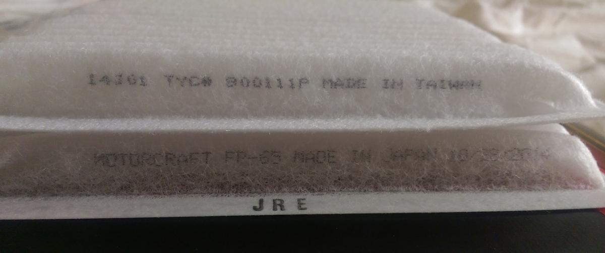

omar302 Posted June 27, 2015 Report Share Posted June 27, 2015 From my experience, I used ATP's carbon (charcoal) cabin air filter & found that air flow is less compared to the Motorcraft filter. TYC's normal (non-charcoal) filter also had more air flow, but the filter surrounding (bezel?) is thick, like ATP's, the filter door has 2 or 3 plastic protruding pieces that are supposed to hold the filter in place when you close the filter door. With the thicker filter surroundings of the TYC & ATP filters, the filter door would actually squeeze the filter in instead of holding it in place. If you look at the filter from the top, you might even see the filter bending becaus of it. 1 Quote Link to comment Share on other sites More sharing options...

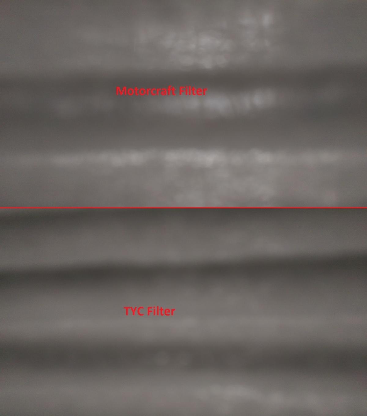

omar302 Posted June 28, 2015 Report Share Posted June 28, 2015 On 6/27/2015 at 3:01 AM, omar302 said: From my experience, I used ATP's carbon (charcoal) cabin air filter & found that air flow is less compared to the Motorcraft filter. TYC's normal (non-charcoal) filter also had more air flow, but the filter surrounding (bezel?) is thick, like ATP's, the filter door has 2 or 3 plastic protruding pieces that are supposed to hold the filter in place when you close the filter door. With the thicker filter surroundings of the TYC & ATP filters, the filter door would actually squeeze the filter in instead of holding it in place. If you look at the filter from the top, you might even see the filter bending becaus of it. Added some images taken yesterday hoping to make things clear. Note: The first one is an "unscientific" comparison showing the Moorcroft Filter more transparent, hence less restrictive in my opinion. Quote Link to comment Share on other sites More sharing options...
WWWPerfA_ZN0W Posted June 28, 2015 Report Share Posted June 28, 2015 Neato! The number of pleats is the same on all 3, so it comes down to the material/size. 1 Quote Link to comment Share on other sites More sharing options...
macbwt Posted June 28, 2015 Author Report Share Posted June 28, 2015 Now we get down to micron filtration. The smaller the opening the less particulates you get swirling around inside. Thus if you want better filtration you need smaller micron openings and in some ways less air flow. Better air flow larger micron openings. Or change the filter more often. Each owner needs to check the filter and then change it according to usage. Since I drive so much I will change mine at least twice if not three times a year maybe more due to usage. To bad we can't install industrial compressed air purge filters then just set it and let the system clean out the filter. LOL On 6/28/2015 at 10:37 AM, WWWPerfA_ZN0W said: Neato! The number of pleats is the same on all 3, so it comes down to the material/size. 1 Quote Link to comment Share on other sites More sharing options...
omar302 Posted June 28, 2015 Report Share Posted June 28, 2015 On 6/28/2015 at 10:37 AM, WWWPerfA_ZN0W said: Neato! The number of pleats is the same on all 3, so it comes down to the material/size. If you look at the ATP vs. TYC picture, you can see how the pleats are shorter in the ATP filter as it has larger/wider bezels. Quote Link to comment Share on other sites More sharing options...
WWWPerfA_ZN0W Posted June 28, 2015 Report Share Posted June 28, 2015 What about motorcraft vs TYC, they look pretty similar in that regard. On 6/28/2015 at 4:46 PM, omar302 said: If you look at the ATP vs. TYC picture, you can see how the pleats are shorter in the ATP filter as it has larger/wider bezels. Quote Link to comment Share on other sites More sharing options...

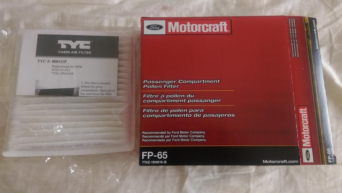

Tacyon Posted June 28, 2015 Report Share Posted June 28, 2015 On 6/27/2015 at 10:16 PM, ExNascarDood said: Anyone have a link to and/or part number for the best replacement filter out there? My 13 seems to have decent airflow but I'm 99% it's going to be the original filer in there and I need to fix that. Thanks. in advance !!! All from RockAuto for a 2011 Ford Edge Limited. They "should" all be the same but verify your specific model. ATP -> https://www.rockauto.com/catalog/moreinfo.php?pk=2478306 ( activated charcoal) ATP-> https://www.rockauto.com/catalog/moreinfo.php?pk=2478488&cc=1446671&jnid=502&jpid=2 ( non- charcoal) TYC -> https://www.rockauto.com/catalog/moreinfo.php?pk=1962988&cc=1446671&jnid=502&jpid=0 (non- charcoal) Motorcraft -> ( non- charcoal) FRAM Fresh Breeze -> https://www.rockauto.com/catalog/moreinfo.php?pk=1392139&cc=1446671&jnid=502&jpid=10 (uses "the natural deodorizing qualities of Arm & Hammer baking soda" - not "Febreze® as you might assume) 1 Quote Link to comment Share on other sites More sharing options...
omar302 Posted June 28, 2015 Report Share Posted June 28, 2015 On 6/28/2015 at 5:23 PM, WWWPerfA_ZN0W said: What about motorcraft vs TYC, they look pretty similar in that regard. Yes. They seem to be the same size. Another interestingt thing I found was that the Motorcraft filter is made in Japan & the TYC in Taiwan. Nothing written on the ATP. Quote Link to comment Share on other sites More sharing options...

omar302 Posted June 29, 2015 Report Share Posted June 29, 2015 On 6/29/2015 at 1:30 AM, enigma-2 said: Seems to be a decent enough filter, haven't noticed any loss of airflow. I had the same feeling at first, but when summer came (temperature reaching 100+ from May to October & peaking 120+), you WILL feel the difference. Quote Link to comment Share on other sites More sharing options...
Tacyon Posted July 2, 2015 Report Share Posted July 2, 2015 (edited) Postman showed up today with -> ATP -> https://www.rockauto....php?pk=2478306 ( activated charcoal) And I must say, of all the bone headed ways to hide or block ease of serviceability, this filter is NOT an example! Including opening the new box and parts baggie, getting at, removing, and comparing physical size, then reinstallation, close up and put crap back in the glove box. .. total time, ~5 minutes. BAM. See if you can guess which is the old one and which is the new one ? p.s. 73,500 miles on a 2011 that I purchased with ~9000 miles on her. So this is probably the 1st change out. Edited July 2, 2015 by Tacyon Quote Link to comment Share on other sites More sharing options...
