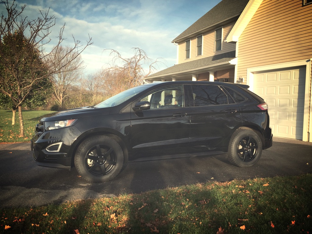

GT500R Posted November 15, 2015 Report Share Posted November 15, 2015 My winter wheel option. Focal F06 black option (18 inch) Blitzzak DM-V2 (245/60/18) I like the look. Plus the tires make the speedo barely off (revs per mile is 0.2% off)! 2 Quote Link to comment Share on other sites More sharing options...
GT500R Posted November 15, 2015 Report Share Posted November 15, 2015 Oh, forgot to add two things. -Stock rim had - 20X8.0J +52.5mm imprinted on the inside of the rim. -This rim and tire combo save 6lbs each side. Stock rim/tire (20inch) weigh 67 lbs and aftermarket weighed 61 lbs. Quote Link to comment Share on other sites More sharing options...
