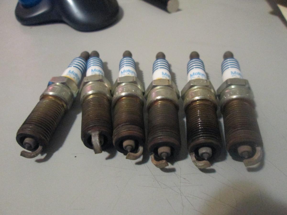

macbwt Posted July 11, 2015 Author Report Share Posted July 11, 2015 My prize for the day. Overall they look OK. These plugs appear to have copper threads. The new ones did not. Overall the engine runs better. Currently working on putting the video together. As I said earlier. The Youtube videos on the first gen 3.5 definately do not reflect the 2nd Gen 3.5 changes. Quote Link to comment Share on other sites More sharing options...
