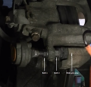

Tacyon Posted June 28, 2015 Report Share Posted June 28, 2015 (edited) macbwt - couple of questions I have. 1) re the transmission flush. What of the trans filter ? Wouldn't you consider doing a trans flush without changing the filter 50% of what is needed or did I miss that part in the video? 2) (see pic) When tightening bolt 1, what keeps bolt 2 from spinning in the slide pin area ? Edited June 28, 2015 by Tacyon 1 Quote Link to comment Share on other sites More sharing options...
macbwt Posted June 29, 2015 Author Report Share Posted June 29, 2015 (edited) Great question on the transmission flush. Thing is I believe the filter is a life time filter as Ford says, but don't quote me on this. WWW or Akirby may be able to answer this more specifically. To access the filter is a some what difficult job and an expense that I never performed. This being said. I never changed the filter on the Orange Crush and the transmission was running great and peeking at 300K miles. For the low frequency dampers and the other caliper pins once you get them to tighten against the caliper bracket friction will then prevent them from spinning. just keep in mind you are not torquing them. Everyone of them tried to spin a bit until they made contact with the caliper and then sandwiched it so to speak. On 6/28/2015 at 9:19 PM, Tacyon said: macbwt - couple of questions I have. 1) re the transmission flush. What of the trans filter ? Wouldn't you consider doing a trans flush without changing the filter 50% of what is needed or did I miss that part in the video? 2) (see pic) When tightening bolt 1, what keeps bolt 2 from spinning in the slide pin area ? Edited June 30, 2015 by macbwt Quote Link to comment Share on other sites More sharing options...
