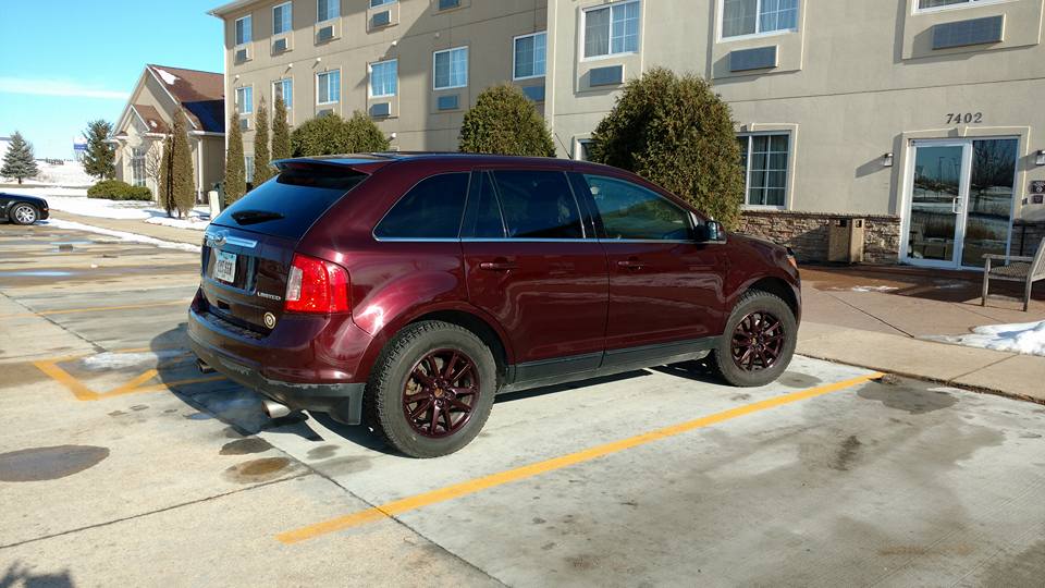

macbwt Posted December 26, 2016 Author Report Share Posted December 26, 2016 Current photo of my Edge (Lullubelle) 1 Quote Link to comment Share on other sites More sharing options...
