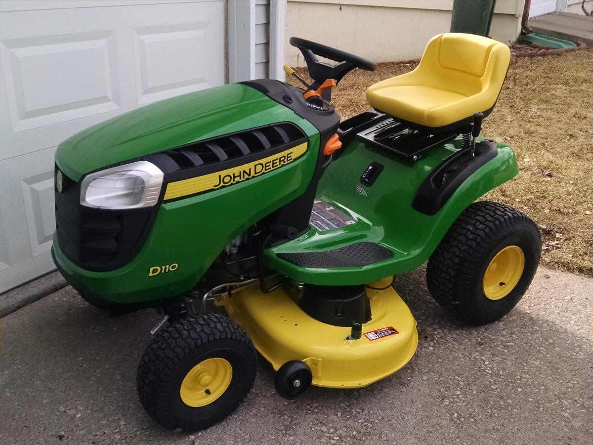

macbwt Posted March 6, 2016 Author Report Share Posted March 6, 2016 My new ride. Top speed 5.5mph in forward and 3.5 in reverse. Getting ready to try her out. LOL spring is just around the corner. 1 Quote Link to comment Share on other sites More sharing options...
