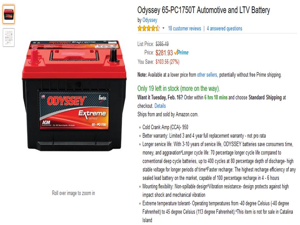

WWWPerfA_ZN0W Posted February 12, 2016 Report Share Posted February 12, 2016 Expensive little buggers! 1 Quote Link to comment Share on other sites More sharing options...
macbwt Posted February 12, 2016 Author Report Share Posted February 12, 2016 Some say buy the 90 or 100 dollar battery. Well this battery will be #3 for the 2011 so if over the time I have the car I have to buy three batteries? How much would I spend? This is not a common core math problem. LOL Expensive little buggers! Quote Link to comment Share on other sites More sharing options...

macbwt Posted February 19, 2016 Author Report Share Posted February 19, 2016 Battery arrived ready for lift off tomorrow!! Now repeat after me.... I will not break anything, I will not break anything, I will not break anything....LOL 1 Quote Link to comment Share on other sites More sharing options...
macbwt Posted February 19, 2016 Author Report Share Posted February 19, 2016 Now to install this battery!!! Going to take the old motorcraft back to the Ford Dealer for a new one. Wonder what kind of grief they are going to give me? At least I will have a spare battery and it is always nice to have a spare. My camper battery is dead so guess I may put it in the camper. Quote Link to comment Share on other sites More sharing options...

macbwt Posted February 28, 2016 Author Report Share Posted February 28, 2016 So far this Odyssey Extreme battery has me extremely happy. Going to install one in MOMOSHA's car. 1 Quote Link to comment Share on other sites More sharing options...
