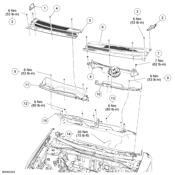

macbwt Posted January 9, 2016 Author Report Share Posted January 9, 2016 WWW any info on how to remove the top plastic cowling to access the strut bearing mount nuts? I am seriously thinking about getting an alldata one year subscription so I have some access to repair information at home. Driving to Rock Island for a simple question sort of sucks. Quote Link to comment Share on other sites More sharing options...
WWWPerfA_ZN0W Posted January 10, 2016 Report Share Posted January 10, 2016 (edited) My info comes straight from an FSM off EBay Are you trying to remove the windshield cowl panel grille (the long flat slotted piece where the wipers come out from)? The manual doesn't mention any need, but it would def be easier! Wiper Pivot Arm — Front Removal and Installation Remove the front wiper pivot arm caps. Remove the front wiper pivot arm retaining nuts and the front wiper pivot arms. To install, tighten to 30 Nm (22 lb-ft). To install, reverse the removal procedure. To adjust the windshield wiper pivot arms, refer to Wiper Blade and Pivot Arm Adjustment — Windshield in this section. Cowl Panel Grille Item Part Number Description 1 020A26 RH cowl side outer panel 2 020A27 LH cowl side outer panel 3 W712648 Upper cowl grille panel screws (4 required) 4 N804837 Upper cowl grille panel scrivet (4 required) 5 02222 RH upper cowl panel 6 02223 LH upper cowl panel 7 17526 Wiper pivot arm assembly bolt (2 required) 8 17508B Wiper pivot arm assembly 9 W707257 Cowl panel extension bolts (6 required) 10 021A37 LH cowl panel extension 11 W707257 RH cowl panel extension 12 W710593 Lower cowl panel bolt (5 required) 13 W702751 Lower cowl panel nut (3 required) 14 W710309 Lower cowl panel-to-front of dash bolt 15 02106 Lower cowl panel Upper and lower cowl grille panel NOTE: The upper cowl panel grille must be removed before the lower cowl panel grille can be removed. Remove the LH and RH wiper pivot arms. For additional information, refer to Section 501-16 .Upper cowl panel grille Remove the RH cowl side outer panel.Remove the LH cowl side outer panel.Remove the 2 scrivets from the RH upper cowl panel grille.Remove the 2 bolts from the RH upper cowl grille panel and remove the RH upper cowl grille panel. To install, tighten to 6 Nm (53 lb-in). Remove the 2 scrivets from the LH upper cowl grille panel.Remove the 2 bolts from the LH upper cowl grille panel and remove the LH upper cowl grille panel. To install, tighten to 6 Nm (53 lb-in). Lower cowl panel grille Remove the wiper arm and wiper pivot shaft assembly. Disconnect the electrical connector. Remove the 2 bolts. To install, tighten to 7 Nm (62 lb-in). Remove the 2 bolts from the upper left lower cowl grille panel extension and remove the panel. To install, tighten to 6 Nm (53 lb-in). Remove the 4 bolts from the upper right lower cowl panel extension and remove the panel. To install, tighten to 6 Nm (53 lb-in). Disconnect the wiring harness from the retainer on the left front of the lower cowl grille panel. Disconnect the electrical connectors from the powertrain control module (PCM). Remove the evaporative purge valve and bracket from the center of the lower cowl panel grille and set aside.Remove the 5 bolts and 3 nuts from inside the lower cowl grille panel. To install, tighten to 9 Nm (80 lb-in). Remove the bolt from the lower cowl panel-to-front of dash. To install, tighten to 20 Nm (15 lb-ft). Remove the lower cowl grille panel and PCM from the vehicle.Upper and lower cowl grille panel CAUTION: Incorrect installation of the lower/upper cowl panel grille may cause damage to the windshield. Make sure the cowl panel grille clips are located under the windshield prior to installation. To install, reverse the removal procedure. Transfer the components as necessary. Adjust the pivot arms. For additional information refer to Section 501-16 . Edited January 10, 2016 by WWWPerfA_ZN0W Quote Link to comment Share on other sites More sharing options...
macbwt Posted January 10, 2016 Author Report Share Posted January 10, 2016 I have not really looked yet to see what type of clearance there is. All I know and remember is that the clearance under the cowl is very tight on the drivers side and could barely get my fingers into that area and it was not fun to get it tightened up either. Maybe there is more clearance in the 2011 (most likely not). Thank for the info. Quote Link to comment Share on other sites More sharing options...
