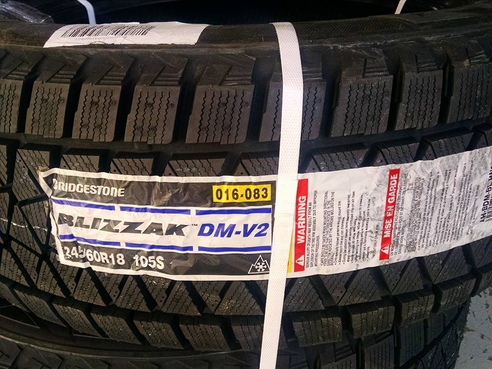

macbwt Posted November 11, 2015 Author Report Share Posted November 11, 2015 New snow shoes on the way for Lullubelle. 245/60R-18 Bridgestone Blizzak DM-V2 Download Warranty Brochure PDF 4 In Stock $166.30 $665.20 1 Quote Link to comment Share on other sites More sharing options...
WWWPerfA_ZN0W Posted November 11, 2015 Report Share Posted November 11, 2015 Wonder if these are any cheaper in the spring? Quote Link to comment Share on other sites More sharing options...
macbwt Posted November 11, 2015 Author Report Share Posted November 11, 2015 No not really. You can get the DM-V1 for less money since it is a discontinued model about 130.00 each. The tread design on the DM-V2 has changed compared to the DM-V1 and the compound has been improved for better wet ice traction according to sales literature. I think in looking at the tread it is a more aggresive design. I guess I will find out if the noise increases due to the tread change. I have two DM-V1 at home that I am going to put on Blueberry with two new DM-V1's on the rear. Wife does not drive much in winter. I will do a short video comparison. Wonder if these are any cheaper in the spring? 1 Quote Link to comment Share on other sites More sharing options...

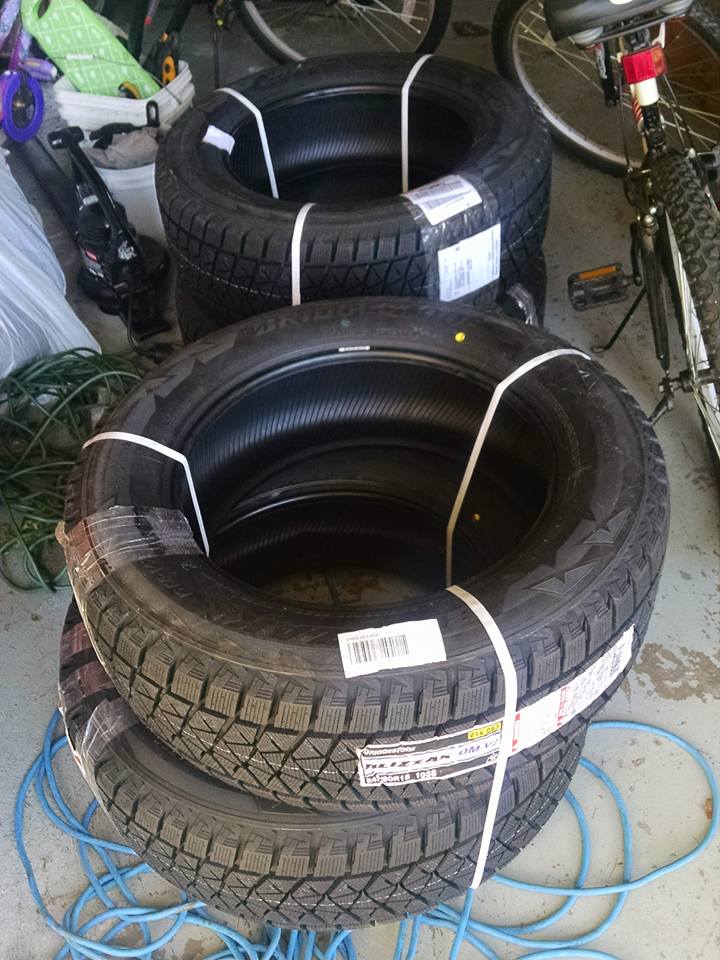

macbwt Posted November 13, 2015 Author Report Share Posted November 13, 2015 The blizzaks were waiting in my garage for me. I had to laugh because my wife made the UPS guy load them in the garage when he delivered them. Soon I will be mounting them when the time is right. Waiting for the weather to cool down a bit more. I like it below 50 degrees consistently before I have them mounted to use. Quote Link to comment Share on other sites More sharing options...
