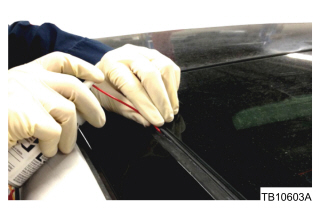

WWWPerfA_ZN0W Posted July 8, 2015 Report Share Posted July 8, 2015 This TSB is for the Lincoln MKZ, but shows how Ford is handing the lubrication of the roof opening panel: TSB 14-0207PANORAMIC ROOF OPENING PANEL – SHUDDER OR VIBRATION – CLOSING OR OPENINGPublication Date: November 6, 2014 LINCOLN: 2013-2015 MKZISSUE:Some 2013-2015 Lincoln MKZ vehicles equipped with a panoramic roof opening panel may exhibit a vibration or shudder when opening or closing the panoramic roof opening panel. This condition is mostly noticed in high ambient temperatures.ACTION:Follow the Service Procedure steps to correct the condition.SERVICE PROCEDUREThe cleaning and lubrication procedure is for the panoramic roof opening panel tracks. The door latch lubricant spray specified in this procedure has unique properties that will help it adhere to the sides of the rails and prevent the rubber components from swelling.1.Bend the handle of a 38.1 mm (1.5 inch) diameter synthetic bottle brush in a 45 degree angle. (Figure 1)Figure 1 - 14-02072.Close the panoramic roof opening panel. Clean both rear panoramic roof opening panel tracks by inserting the modified bottle brush from step 1 at the center of the driver’s side rear track and slide the brush up and down the full length of the rear track 3 times. Repeat on the passenger side panoramic roof opening panel rear track. a.Wipe the brush with a shop towel to remove any grease or debris after cleaning each track.3.Insert an air nozzle into the top of the driver’s side panoramic roof opening panel rear track between the seals and blow out any loose debris while moving the air nozzle down the track. Repeat on the passenger side panoramic roof opening panel rear track.4.Start at the top of the panoramic roof opening panel on both rear tracks. a.Insert the spray applicator so it is pointing towards the inner (inside) track. Spray the Door Latch Lubricant to make sure the spray is directed at the inner side portion of the track and not sprayed directly down. Repeat on the other side rear track. (Figure 2)Figure 2 - 14-0207 b.Insert the spray applicator so it is pointing towards the outer track. Spray the Door Latch Lubricant to make sure the spray is directed toward the out side portion of the track and not sprayed directly down. c.Spray the Door Latch Lubricant while moving the applicator down the track stopping about 152 mm (6 inches) from the bottom of the back glass. It should take approximately 4 seconds to spray from the top to the bottom of the track.5.Move the panoramic roof opening panel to the full open position. Cover the opening to protect the vehicle interior from over spray.6.On both panoramic roof opening panel tracks place a shop towel in the center of the track which is part of the front S curve. The section of the track which pulls the roof down. (Figure 3) a.If a shop towel is not in place, excess lubricant may seep through the seam in the center of the S curve and drip onto the top of the headliner.7.On both panoramic roof opening panel tracks start at the front of the track. a.Position the spray applicator so it is pointing towards the inner side portion of the track and slightly rearward. While moving the applicator rearward down the track, apply the lubricant to within 51 mm (2 inches) of the front lifter arm. (Figure 3) Figure 3 - 14-0207 b.Position the spray applicator so it is pointing toward the outer side portion of the track, and slightly rearward. While moving the applicator rearward in the track, apply the lubricant to within 51 mm (2 inches) of the front lifter arm. c.Application should take approximately 3 seconds of spraying time when spraying from the front of the track to the rear.8.On both panoramic roof opening panel tracks place a shop towel around the end of a plastic trim tool that will fit down in between the tracks. Run it up and down the front track assembly to wipe the excess lubricant from the center of the track that might have drained from both side rails.9.Remove the shop towels and cycle the panoramic roof opening panel open and closed 3 times.10.Open the rear decklid and on both sides, wipe the excess lubricant that may have drained from the rear track onto the luggage compartment surrounding trim.Obtain Locally Synthetic Bottle Brush – 38.1 mm (1.5 inch) diameterPART NUMBER PART NAME5U7Z-19A501-A Door Latch LubricantOPERATION DESCRIPTION TIME140207A 2013-2015 MKZ: Clean And Lubricate Panoramic Roof Opening Panel Rails Following The Service Procedure (Do Not Use With Any Other Labor Operations) 0.4 Hr.WARRANTY STATUSEligible Under Provisions Of New Vehicle Limited Warranty Coverage.Warranty/ESP coverage limits/policies/prior approvals are not altered by a TSB. Warranty/ESP coverage limits are determined by the identified causal part and verified using the OASIS part coverage tool.DEALER CODINGBASIC PART NO. CONDITION CODE54502P68 41 2 Quote Link to comment Share on other sites More sharing options...
CinnamonEdge Posted July 10, 2015 Author Report Share Posted July 10, 2015 Awesome find. I bet that is a synthetic lube that they use. The only problem with the vista roof is the way the rear section of roof is exposed to the weather and rain water, sand and dirt get washed past the rubber seals and into the lubricant of the tracks. My thoughts are that it should be cleaned and lubed at least every 10,000 miles or at every oil change. 2 Quote Link to comment Share on other sites More sharing options...
WWWPerfA_ZN0W Posted July 10, 2015 Report Share Posted July 10, 2015 This is what Ford lists on their lubricants/greases page: http://www.fordparts.com/Products/Chemicals-Greases.aspx And here is the specific product mentioned in the TSB: https://www.fcsdchemicalsandlubricants.com/Main/msds/us174336us_supplier.pdf Ford Multipurpose Dry Film Door Latch Lube - Aerosol 5U7Z-19A501-A.pdf LONG LIFE LUBRICATING (XL5) Could be Teflon, Silicone, Graphite ??? 1 Quote Link to comment Share on other sites More sharing options...
CinnamonEdge Posted July 11, 2015 Author Report Share Posted July 11, 2015 Could be Teflon, Silicone, Graphite ??? Probabbly Teflon. The problem with dry film is that it wears down fast on the aluminum tracks. Then you have the silicone(dielectric) or Lithium grease used on most sunroofs. Greases collect dirt over time but dont wear away as fast. So both require frequent cleaning and reapplication. Can't win. 1 Quote Link to comment Share on other sites More sharing options...
