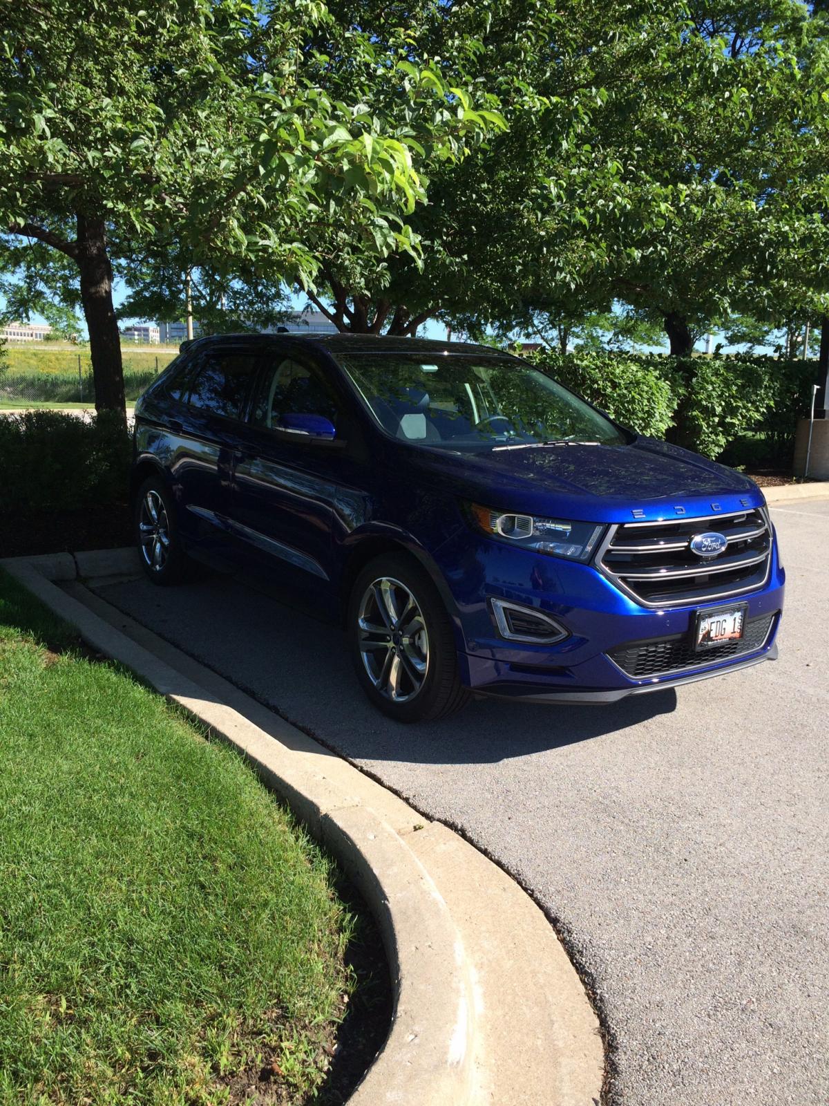

ruby1025 Posted June 10, 2015 Report Share Posted June 10, 2015 (edited) Hello. I LOVE my 2015 Ford Edge Sport AWD Ecoboost 2.7 in Deep Impact Blue Metallic! Great car, fast as heck, not slow to respond like my 2013 Edge Sport was. But here are my complaints so far...1. I feel the seat is hitting me funny. Causes discomfort. Can't go down low enough due to bracket I believe so sit up higher. I can't find a comfortable distance from the wheel to the seat where my feet reach the brake and gas petals and my arms reach the wheel.2. Horrible rattles from my panoramic roof. Took it to the dealer on day 2, they kept it two days, replaced clips and cleaned up the debri from the tracks. Got it back, rattled on ride home. Deflated. I took it back next week. Dealer had it for 3 days. I came and test drove it. Tech heard the rattles. Got it back and they could not replicate rattles. So I left. I know have a $42,000 car that rattles so loudly and so badly that my passengers just laugh at me. Sad as it's a HOT CUV. I see that the escape had similar issues. I hope to resolve this in the colder months with the dealer. As the temp rises the rattle is less. Humidity stops it all together. Worse with moonroof popped up or open. I attached the voice note I recorded, but the videos are MUCH better but too large to attach sadly.3. I wish the door rests would come into the cablin about 2 more inches so my arm would rest on it while I drive. Maybe my arm is short. I don't think so. My arm rested on the one in my 2013 just great. Just something I noticed. I'm 5'7".4. Sunvisor is short. Doesn't seem to block the sun like other used too. Annoying.5. Got a nail in front tire while testing it with dealer. Looks like tires are hard to find in stock when u need them to be, so have to go to dealer. Updated, was removed without loss of air! 6. The Mytouch screen is up and a bit of a reach now, so may not be the best place for it. I know the 2016 will have the new app like screen so maybe it won't matter as it could be in a new place.7. The Driver Alert System needs to be reset keeps coming on. I have turned it off and on software wise thru menu but still happens.8. Front ground effect behind wheel where mud flap would go attaches loosely and pulls out of place. This is the design at least on this car. I've had to push it flush against body several times now.Otherwise, I love it. No leaks, been out in the rain a lot. So I think the pillar TB is not something I am affected by. Thank the Lord for that. 20150611 062714.mp3 Edited July 1, 2015 by ruby1025 Quote Link to comment Share on other sites More sharing options...
