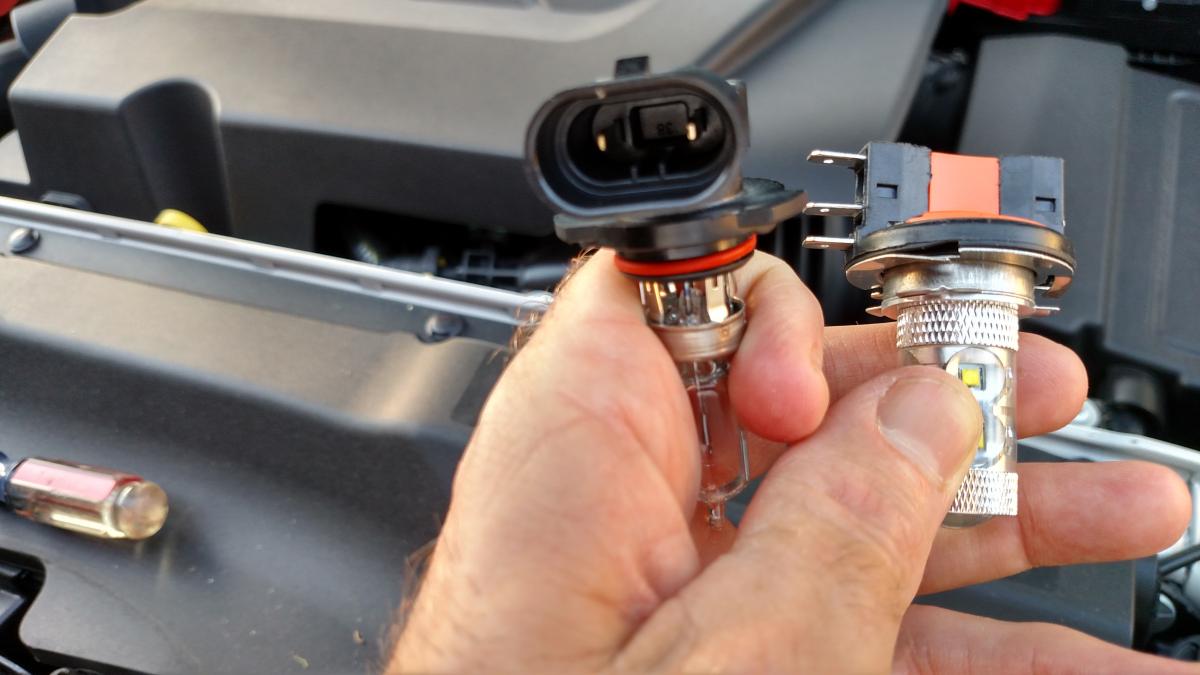

s4tom3 Posted August 8, 2015 Report Share Posted August 8, 2015 What am I missing here. Have a non HID equipped Sport and went to install new DRL bulbs from the OP and they are not compatible. They are 9005 bulbs, not H15's. Quote Link to comment Share on other sites More sharing options...
omar302 Posted August 8, 2015 Report Share Posted August 8, 2015 (edited) What am I missing here. Have a non HID equipped Sport and went to install new DRL bulbs from the OP and they are not compatible. They are 9005 bulbs, not H15's.OP has factory equipped HID lights. So it's not the same setup as yours. Edit: Just noticed in your photos, you shouldn't touch the glass part of halogen bulbs as the oil from your hand could cause the bulb to break the next time the headlamps are operated. Edited August 8, 2015 by omar302 Quote Link to comment Share on other sites More sharing options...
built2prfctn Posted August 8, 2015 Author Report Share Posted August 8, 2015 What am I missing here. Have a non HID equipped Sport and went to install new DRL bulbs from the OP and they are not compatible. They are 9005 bulbs, not H15's. These bulbs are only for HID 401A package editions Quote Link to comment Share on other sites More sharing options...
s4tom3 Posted August 9, 2015 Report Share Posted August 9, 2015 I guess I just cleared up the confusion. Need to return H15's. Should have pulled out the bulbs to confirm compatibility. They do make the same bulb in 9005 style. Any others make this mod with the 9005 bulb? Quote Link to comment Share on other sites More sharing options...
