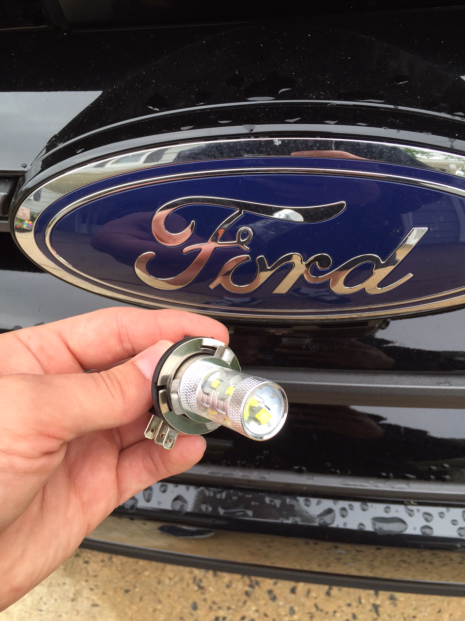

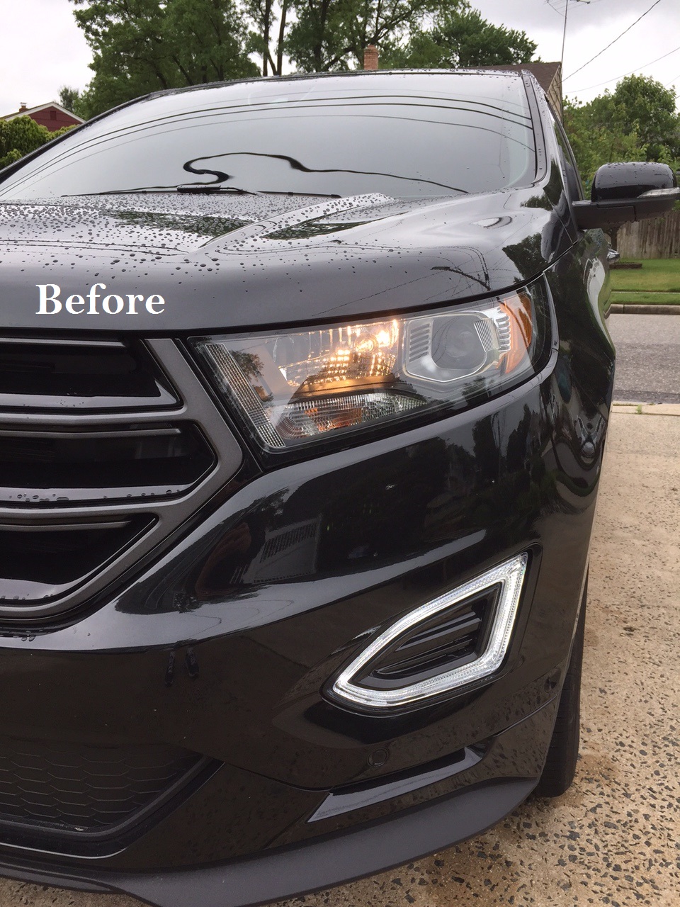

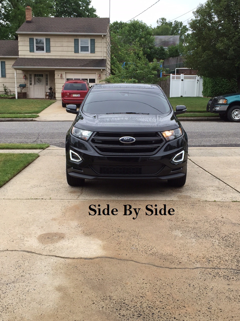

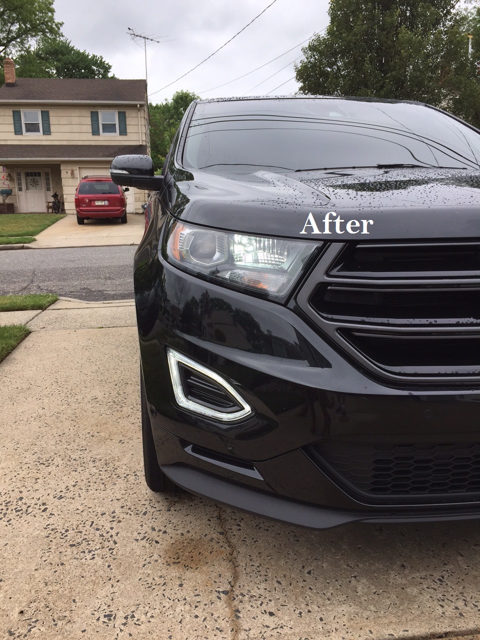

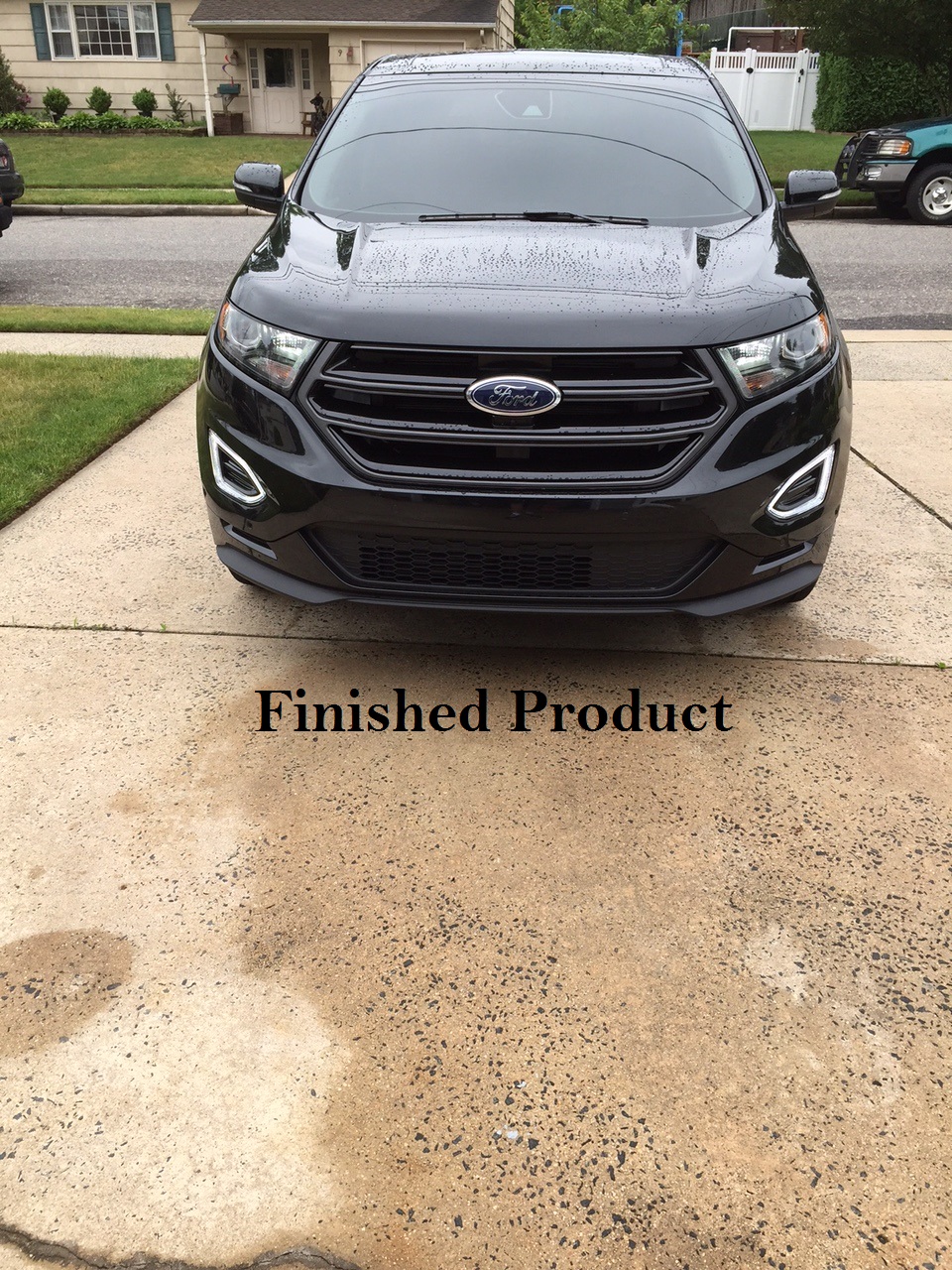

built2prfctn Posted June 3, 2015 Report Share Posted June 3, 2015 Hey guys hated those ugly DRL's so i replaced them. (Very Simple) Here's the link to the bulbs I got .http://www.amazon.com/iJDMTOY-Mercedes-Volkswagen-Daytime-Running/dp/B00TQ662OW/ref=sr_1_1?ie=UTF8&qid=1433370975&sr=8-1&keywords=iJDMTOY+%282%29+Xenon+White+50W+CREE+H15+LED+Bulbs+For+Audi+BMW+Mercedes+Volkswagen+For+Daytime+Running+Lights See Pictures! 8 Quote Link to comment Share on other sites More sharing options...

built2prfctn Posted June 4, 2015 Author Report Share Posted June 4, 2015 Looks much improved. I hate the yellow DRL compared to the nice bright white HIDs and LED driving lights. I may have to do this myself! Any "gotchas" with installation, or just unplug, unscrew, and reverse? Very simple. Take rubber boot off to access bulb and just twist comes right out. Quote Link to comment Share on other sites More sharing options...

torquer Posted June 14, 2015 Report Share Posted June 14, 2015 +1 to the OP for posting this. I got the same bulbs and put them in no problem. No issues, no dummy lights on the dash, no problems whatsoever. It is possible that being white vs yellow they are less visible to other drivers (defeating the purpose of DRLs to begin with), but they look a million times better. You have no idea just how yellow the stockers were until you see the comparison in person Quote Link to comment Share on other sites More sharing options...
