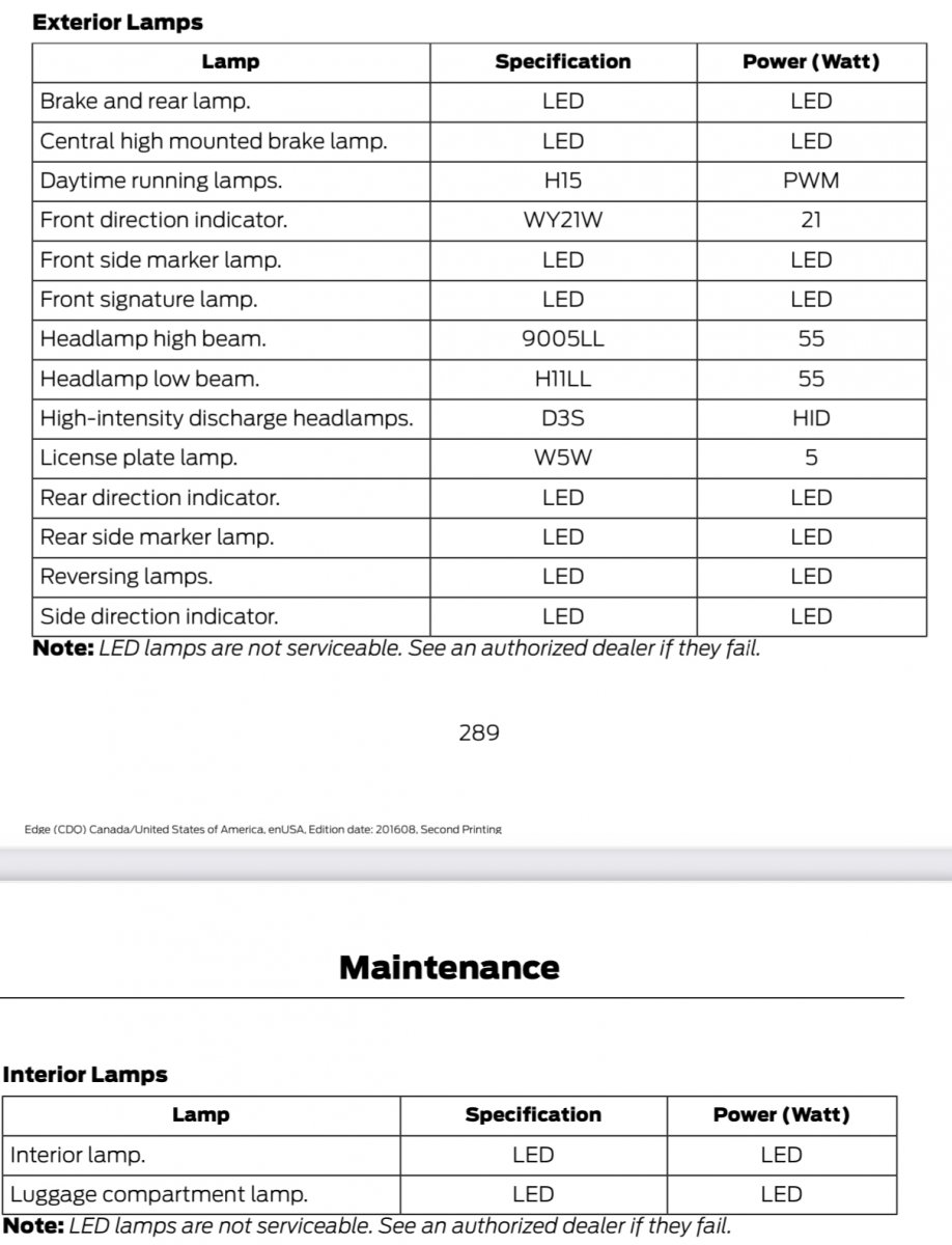

CameronDouglas Posted March 29, 2021 Report Share Posted March 29, 2021 anyone have the interior bulb sizes for the 2017 sport? Quote Link to comment Share on other sites More sharing options...
omar302 Posted March 29, 2021 Report Share Posted March 29, 2021 36 minutes ago, CameronDouglas said: anyone have the interior bulb sizes for the 2017 sport? They are all Leds, not regular replaceable bulbs except for the vanity mirror light (in the front sun visors). Quote Link to comment Share on other sites More sharing options...
enigma-2 Posted March 30, 2021 Report Share Posted March 30, 2021 The bulb replacement chart is on page 289 on the owners manual. Quote Link to comment Share on other sites More sharing options...
CameronDouglas Posted March 30, 2021 Report Share Posted March 30, 2021 (edited) 20 hours ago, enigma-2 said: The bulb replacement chart is on page 289 on the owners manual. It only says LED and not the bulb size to go off of. Edited March 30, 2021 by CameronDouglas 1 Quote Link to comment Share on other sites More sharing options...
