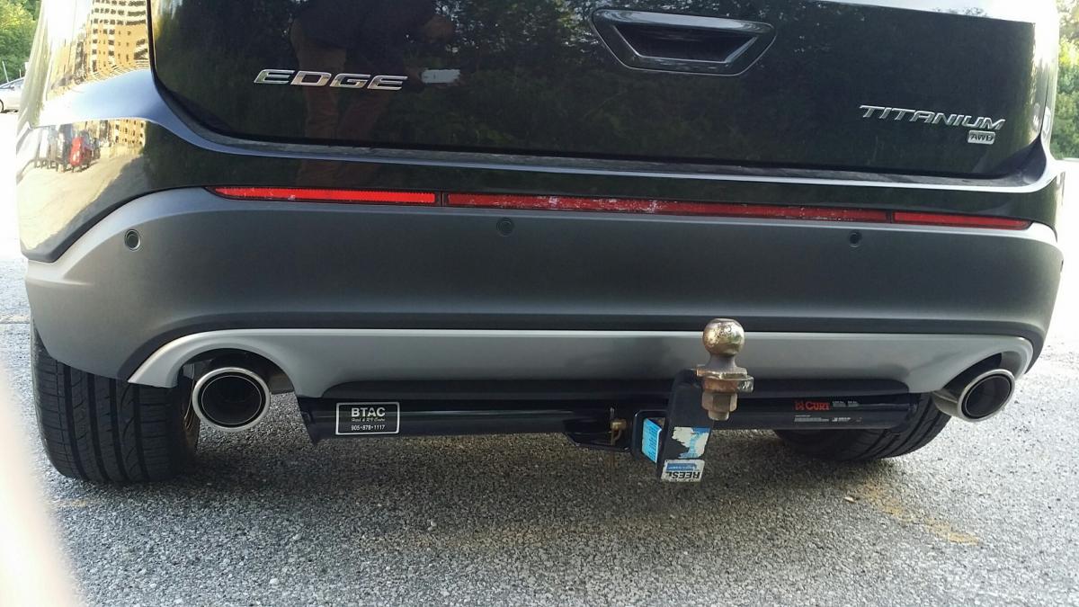

kaushen79 Posted June 4, 2015 Report Share Posted June 4, 2015 Hi All, I have a 2015 Titanium and didn't get the ford factory hitch - but had ford install a Class III aftermarket hitch for me (included in the negotiation of the sale of the car). The hitch that was installed was the 13224 Curt Class 3 Trailer Hitch Receiver The aftermarket hitch sits below the bumper and doesn't require you to cut into it. I can confirm that the hands free liftgate works flawlessly with the aftermarket hitch. I located the liftgate sensor, it is dead center underneath the bumper - just on top of the hitch receiver. (You can see the cutout in the second picture.) Kicking to the left or the right of the sensor triggers the liftgate to open. Cheers, Conrad 3 Quote Link to comment Share on other sites More sharing options...
