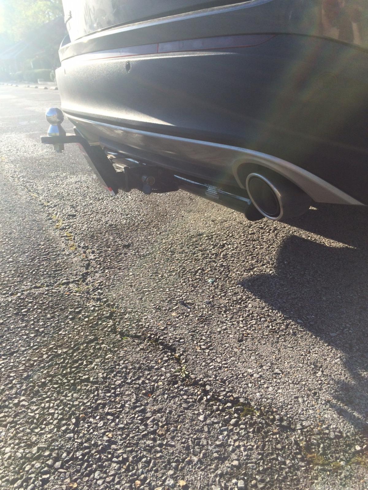

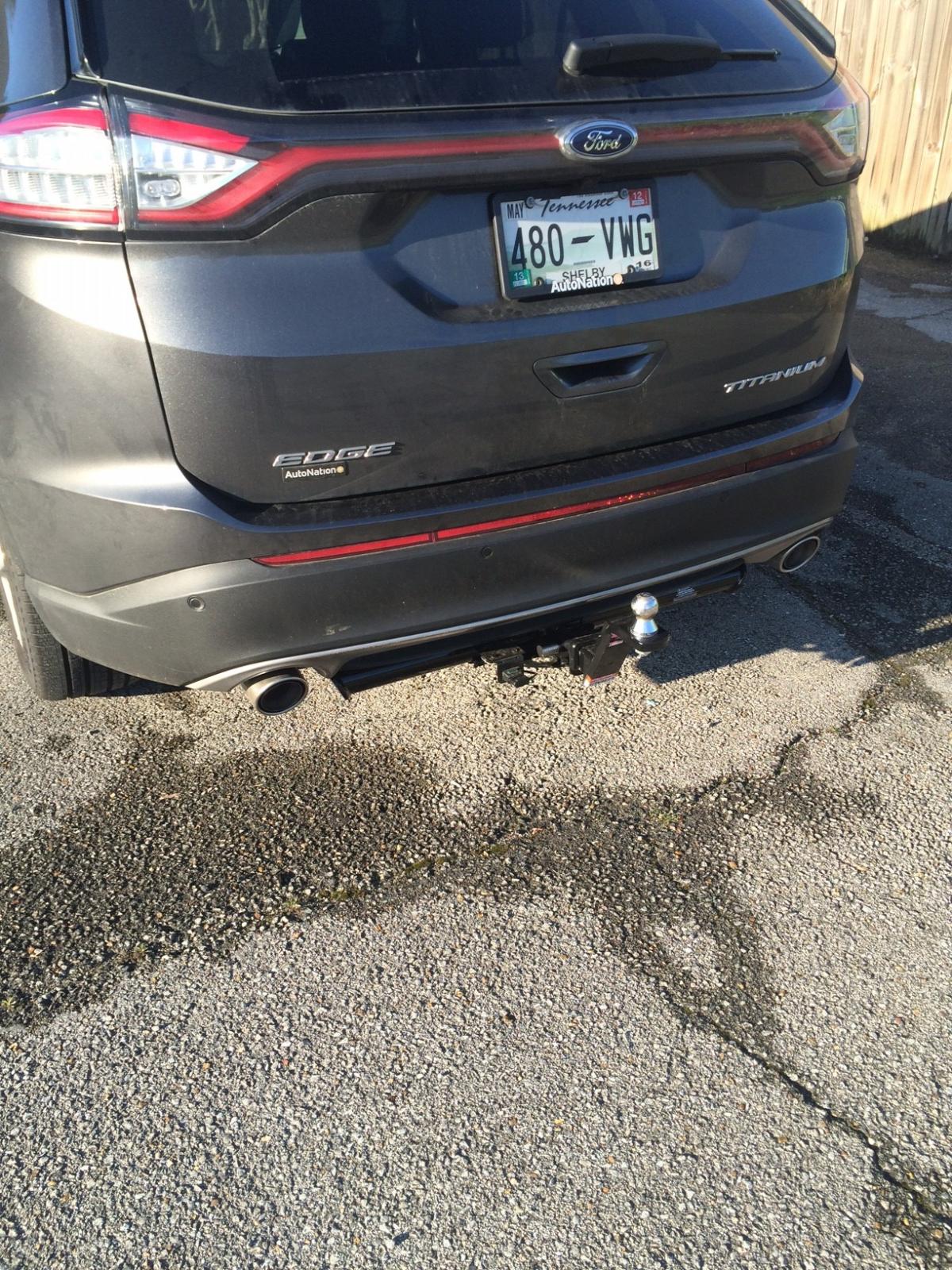

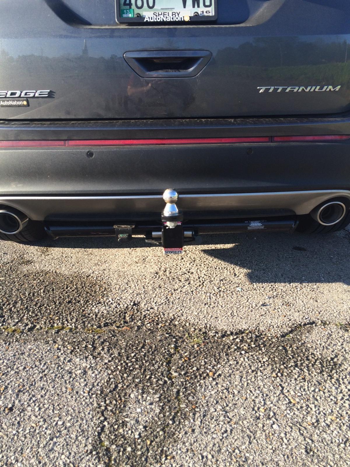

Denicio Posted May 11, 2016 Report Share Posted May 11, 2016 Here is the job Uhaul did on my 2015 Titanium. Thanks for the tips on how to post pictures! 1 Quote Link to comment Share on other sites More sharing options...

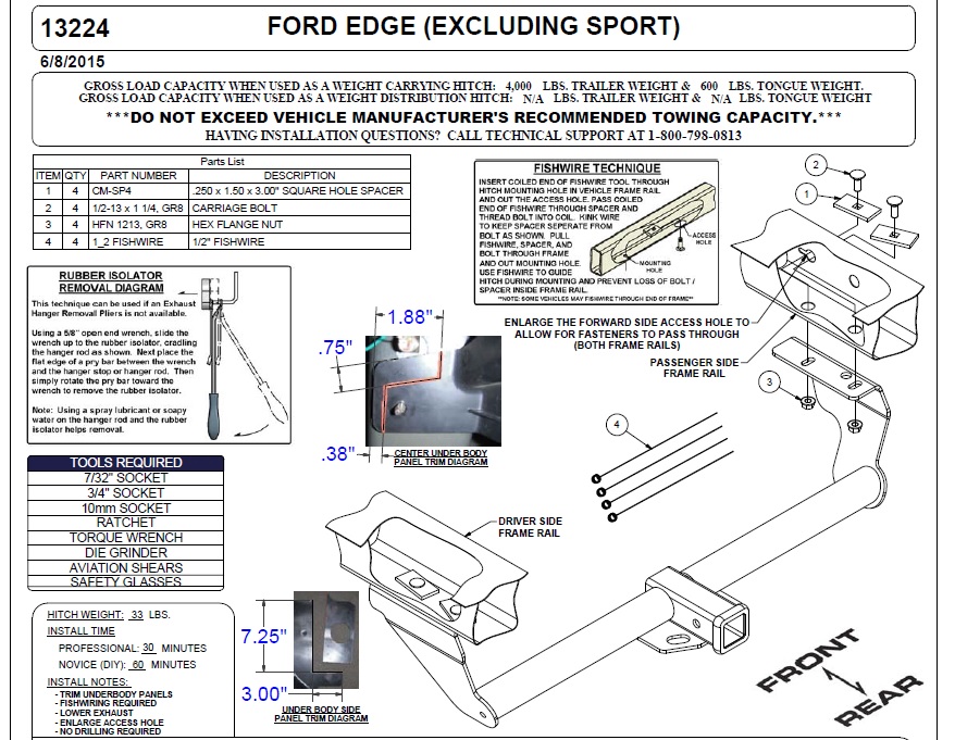

skyvvalker Posted May 11, 2016 Report Share Posted May 11, 2016 I think I'm going to go with the self install Hidden Hitch on my 2016 SEL Edge, rather than the Curt Hitch (which UHaul uses). If you look at the diagrams for both hitches (see picture attachments or installation instructions), it is clear that the Hidden Hitch square bar sits higher than the round tube of the Curt Hitch, and is therefore less visible. It is worth noting, that the receiver will be at the same height for either hitch installation. BTW, the fact that the Hidden Hitch uses 4 bolts on each side vs 2 bolts on each side for the Curt Hitch, should make for a more robust mounting with the Hidden Hitch. Also, I'm not sure why Curt Hitch is calling for one of the side holes of the "frame" to be made larger for the spacer to get inserted (see CurtHitch2 picture), when it looks like there is already a wider hole forward of the side mounting holes on the "frame", which the Hidden Hitch instructions reference (see HiddenHitch2 picture). Finally, Etrailer.com has posted a nice video for installing the Curt Hitch on a 2015 Edge. Though I plan on installing the Hidden Hitch, some of the steps are the same between the 2 installations: https://www.youtube.com/watch?v=8tBv4AOIV_8 They also have a 2015 Edge trailer wiring harness install video: https://www.youtube.com/watch?v=2lM9HwpNu6E CQT75234.pdfFetching info... CM_13224_INS.PDFFetching info... 1 Quote Link to comment Share on other sites More sharing options...

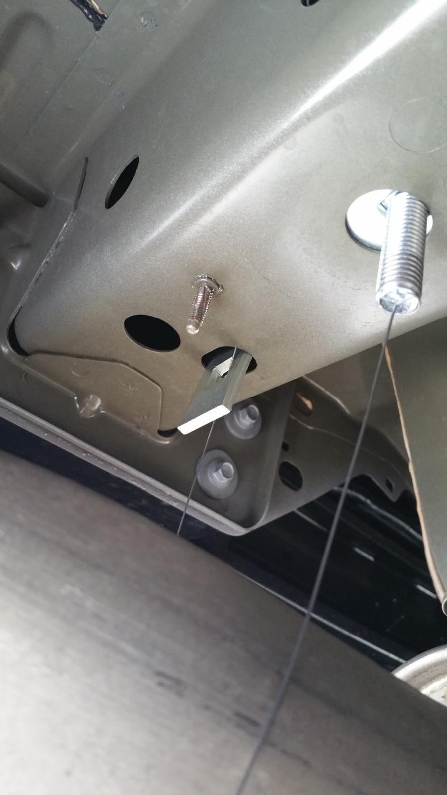

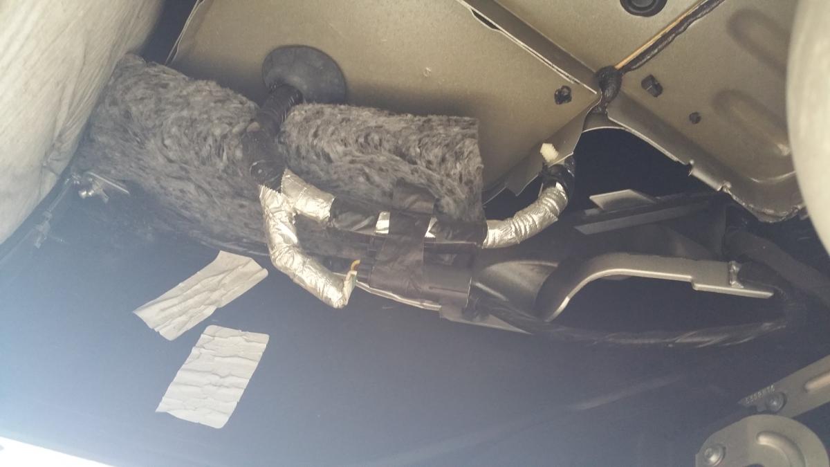

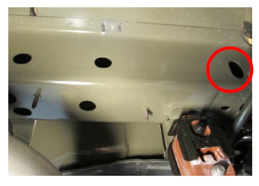

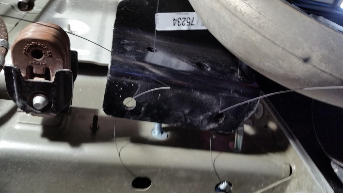

postman Posted July 9, 2016 Report Share Posted July 9, 2016 (edited) Just installed a Draw-Tite 75234 that I got from Amazon for $141 with free shipping. I also purchased a T connector wiring kit for $55 made by Tekonsha. It connects without cutting any wires.Draw-Tite is made by Cequent, which labels them for Hidden Hitch, Draw-tite and Reese. Installation did take a couple hours having the back end up on ramps. You do need a 5.5 and 10mm socket, but I didn't need a torx bit. I think that's only for the Lincoln model. Somebody posted they had to remove the exhaust rings? I don't think that was in the instructions. I just pulled the plastic fascia a little and the exhaust dropped down. Not real happy that the hitch only has 8" of ground clearance. There is plenty of room to move the hitch up, just requires some cutting of the fascia. I've seen other year models that have the fascia cut for the hitch and they look fine.Also the hole I use in the picture is a lot closer and easier to feed the wire through. I only takes a couple passes with a file to allow the large washer to fit.Also found a wiring harness on the passenger sire, see picture. I wonder if it was for the factory trailer wiring kit. Edited July 9, 2016 by postman 2 Quote Link to comment Share on other sites More sharing options...

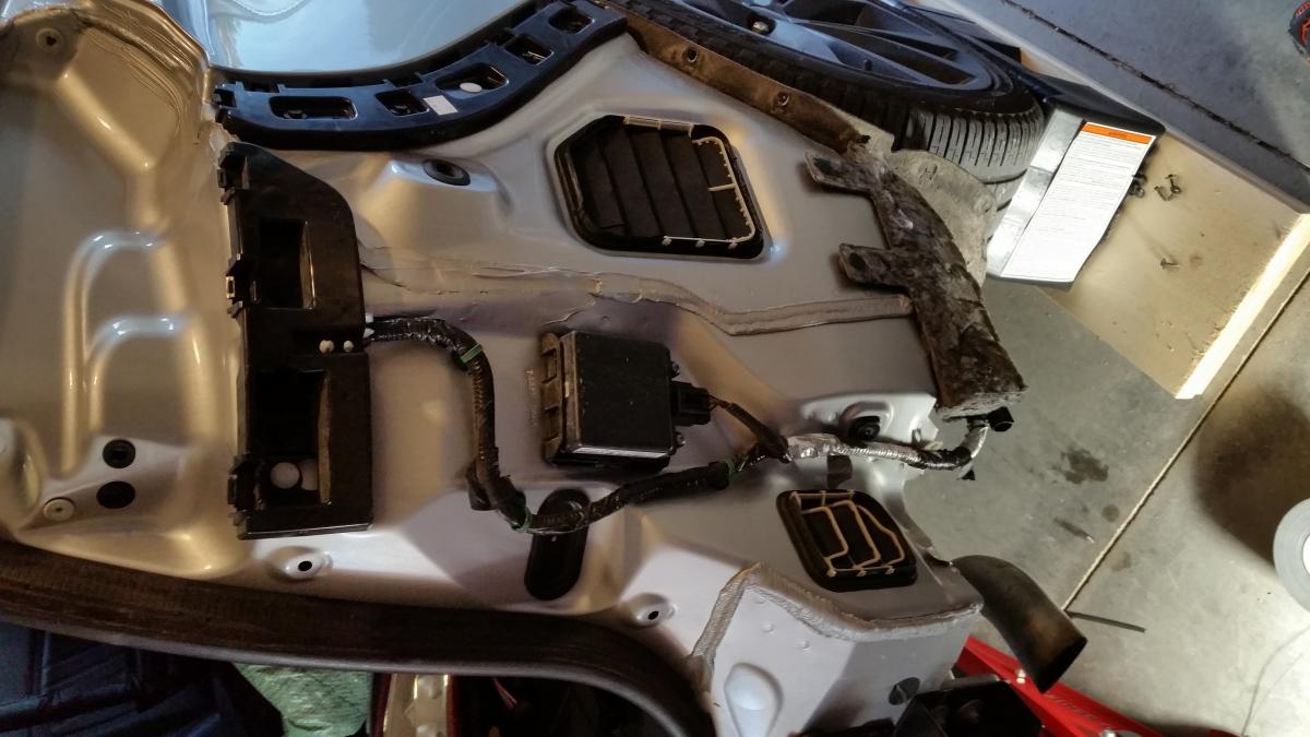

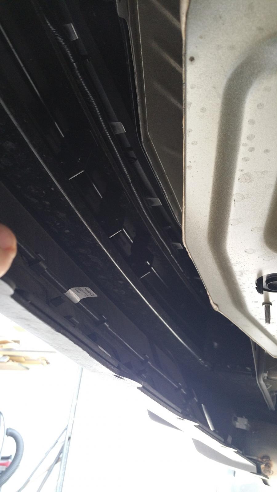

Beezz Posted August 10, 2016 Report Share Posted August 10, 2016 (edited) Installed a Draw-Tite Max-Frame Trailer Hitch Receiver Class III for my 15' sport today, along with a T-One wiring harness. The job was a complete pain, it will help if you have 2 people and are able to lift the car up pretty high, otherwise you'll be fighting with everything. It took me a few hours to get the hitch installed, the exhaust had to come down for me to be able to bolt in the hitch. I think an easier approach would be to remove the bumper, which I ended up doing to install the wiring harness. There was literally no room to pull up the wiring as stated in the instructions, you run the risk of damaging a lot of stuff behind the bumper. Also, I highly suggest washing your car the day before you install a hitch, you really dont want stuff dripping onto your face while you're under there. I didn't wash it at all and was battling mud and stone dust the entire day. Duct tape on the guide wires also helps to locate them after you slide them into the 'frame'. The lift-gate sensor still works, just not right under the hitch receiver. I am going to try to wire the power for the light controller into the 12v outlet in the trunk. attached: right side rear wiring, just remove the bumper, unbolt the top black bumper support and slide the wires in (similar on both sides) left side hitch with bolts and guide wires Edited August 10, 2016 by Beezz Quote Link to comment Share on other sites More sharing options...

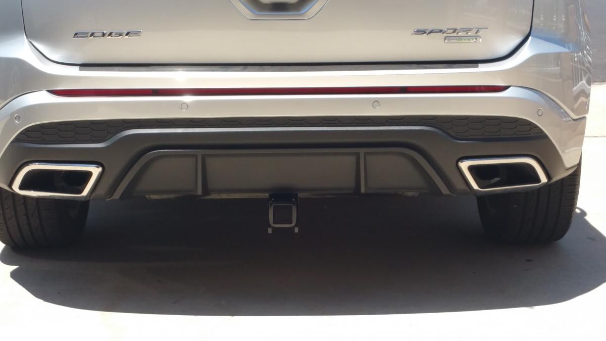

jmr061 Posted August 10, 2016 Report Share Posted August 10, 2016 I put the Draw-Tite on my 16 Sport along with the included wiring. I too am disappointed with the low clearance of the receiver but hey...give and take for getting a sport. I didn't have to remove the bumper cover to install the wiring though I did pop it off a little but from the retainers where the taillights sit. That gave enough room to run the wiring from bottom up to the lights. I also took off the white plastic holder on the original vehicle side of the electrical connector for each light and put it on the trailer light kit of the same plug. I then shoved the original connector down further and clipped the trailer light kit plug where the original factory one went. That means I didn't have to try to tuck and hide the trailer wiring to get the lights back in. I also ran power for the light controller from the fuel pump power. There is a small hole in the spare tire well that you can pop out a dime size plug and send your power wire through (of course I used wire loom and resinstalled the grommet and sealed it). The trailer lights will only work in the ignition on position. Not ideal but I don't plan on breaking down while towing (I hope!!). I would choose a source that can handle the amps for your taillights in addition to what it is already driving. I have LED taillights so no biggie and I fuse it on the at 7.5 amps instead of 10. As far as the 12V power outlets...one of the F150 guys found that timer for those is adjustable via programming or can be turn on all the time or off all the time (when ignition off). Quote Link to comment Share on other sites More sharing options...

Malifestro Posted July 3, 2017 Report Share Posted July 3, 2017 Clearly the hidden hitch / draw-tite is a good option but what if you want it up higher. Has no one here ever even attempted to figure out what it would take? If all that is holding up the install is to cut the black plastic, that isn't a big deal. I'd rather do that then have it 4 inches lower under the bumper. Has anyone done or figured out if installing the factory hitch on the sport is an option? Just snagged my Sport last night, and I'll have a hitch on it at some point. Thanks for some input! Quote Link to comment Share on other sites More sharing options...
