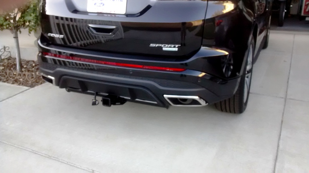

built2prfctn Posted July 30, 2015 Author Report Share Posted July 30, 2015 Yes, got the hitch and harness from curt. The part numbers are 13224 for the hitch, and 56272 for the harness. Was $200 shipped (Canadian). Pretty good deal! I was thinking about going with the hidden hitch but it actually looks like the curt is covered more. Cool post pictures when done. Quote Link to comment Share on other sites More sharing options...

jalm111 Posted September 10, 2015 Report Share Posted September 10, 2015 Got the curt hitch installed on my Sport today for $280 labor included. I did not get the wiring as we have an MDX that we use for towing, this is just for my bike rack/etc. More or less meh about it... I like that I finally have a hitch, hate that it's not hidden under the bumper. Maybe I'll post pics later but it more or less looks the same as the one duder above with his silver sport. Quote Link to comment Share on other sites More sharing options...
Jimmy Sosinski Posted September 15, 2015 Report Share Posted September 15, 2015 (edited) The pictures that have been taken are very deceiving since they are from a standing position. Some of the pics you can really see the cross bar and I know I would hate to see that from the back. I hope hidden hitch somehow conceals it more but there is not much room in the rear. I do really need a hitch for my bike racks!!! It is a pain traveling to races with the bike in the car and a wife and a 3 year old! Edited September 15, 2015 by Jimmy Sosinski Quote Link to comment Share on other sites More sharing options...
WingNut Posted September 15, 2015 Report Share Posted September 15, 2015 The pictures that have been taken are very deceiving since they are from a standing position. Some of the pics you can really see the cross bar and I know I would hate to see that from the back. I hope hidden hitch somehow conceals it more but there is not much room in the rear. I do really need a hitch for my bike racks!!! It is a pain traveling to races with the bike in the car and a wife and a 3 year old! Throw the bike on a roof rack? Quote Link to comment Share on other sites More sharing options...

Jimmy Sosinski Posted September 16, 2015 Report Share Posted September 16, 2015 Yes, got the hitch and harness from curt. The part numbers are 13224 for the hitch, and 56272 for the harness. Was $200 shipped (Canadian). Pretty good deal! I was thinking about going with the hidden hitch but it actually looks like the curt is covered more. Isn't the correct part number #13234? That is the one that mentions the sport model in the directions. The #13224 says not sport. Quote Link to comment Share on other sites More sharing options...
Vadimus Posted September 16, 2015 Report Share Posted September 16, 2015 Isn't the correct part number #13234? That is the one that mentions the sport model in the directions. The #13224 says not sport. I've checked installation manual for #13234, it does mention extra step for Sport (removing exhaust bezels using 5.5mm socket and a T20 Torx bit). Quote Link to comment Share on other sites More sharing options...

Bobs2015EdgeSport Posted October 10, 2015 Report Share Posted October 10, 2015 I put a Class-III (2" receiver) Curt hitch on my 2015 Sport just the other day... the correct hitch in this size is Curt #13234 ($157.59 from Hitchmart online) and the correct wiring kit is Curt # 56272 ($69.88 from Hitchmart online). Their instructions stated that it should take an "expert" installer about 30 minutes to install the hitch, and a "novice" about 60 minutes; their estimate was laughable, at best! I'm not a novice, as I have done a few of these before, but in this case, it took me about 4 hours, due to all the disassembly you have to do first (lowering the rear of the exhaust system; removing the Sport exhaust bezels first, etc... plus, it was a bear fishing the bolts and backing plates up through those tiny hidden openings in the rear of the frame rails... all issues which combined to slow-down my progress considerably. However... once the hitch was installed, I was VERY pleased with the look (as noted in the attached photo). The hitch is powdercoated black, and I think it looks just fine, but that's one man's opinion. Sadly, when I tested the wiring kit and module that I had just installed, the turn signals and running lights all worked fine... but I had no stoplamps whatsoever! However, I called Curt and they were very helpful in providing technical support, and they immediately sent me out a new replacement module (which I'm hoping to install and re-test this weekend, hopefully with better results). 1 Quote Link to comment Share on other sites More sharing options...
Bobs2015EdgeSport Posted October 21, 2015 Report Share Posted October 21, 2015 A follow-up regarding my earlier wiring-kit problems: Although Curt sent me a new (and slightly-different) wiring module, I STILL had no brake lights coming out of the module after splicing-in the new one. I then traced and tested all the wiring back to the L/H OEM wiring harness connector, and found that I had a stop lamp signal going IN to the rear lamp housing... but no stop signal coming back OUT of either the lamp housing nor the Curt wiring harness. This therefore resulted in my getting no stop lamp signal going into the Curt module (and obviously nothing then going out of the module down to the trailer connector harness. Ironically, the new module that Curt sent me had an extra lead going into it... one that my original module did not have. It was colored Red and labeled "Stop-lamps". In the interest of having already spent too much time on this problem, I decided to run that lead up to the stop lamp lead (going into the tail lamp assembly), and suddenly I finally had my stop lamp signal showing-up at the 4-flat wiring harness going to the trailer! I then re-ran this extra wire to the stop-lamp lead on a permanent basis, and put it all back together... and the problem is finally solved. I have no idea as to why their #56272 kit was not working as designed on my particular car, but at least I finally got that issue resolved (although via using an extra input wire to do it)... but, as long as it's now working, right? Quote Link to comment Share on other sites More sharing options...
