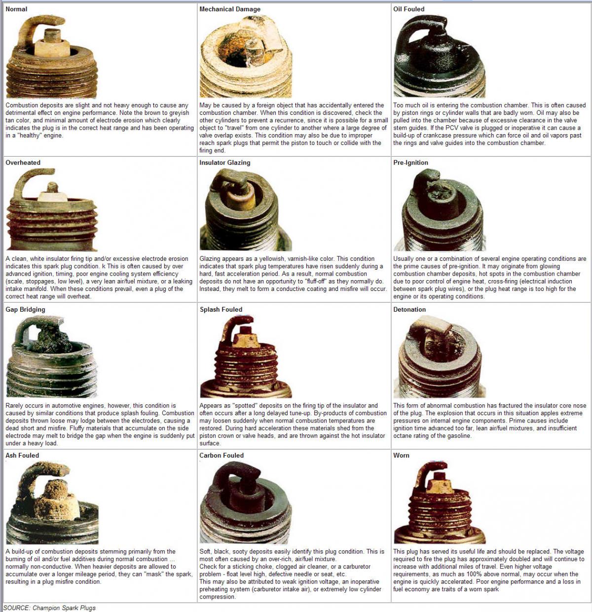

WWWPerfA_ZN0W Posted May 11, 2015 Report Share Posted May 11, 2015 Unfortunately, the 2007 Edge does not have a fuel pressure monitoring system, so you can't read it through the OBD port. The fuel rail Schraeder valve is all you have to go by. At best, you could hook up a gauge to the valve and see what the readings are at different engine RPMs, but that may not be a true test for the misfire/sputter. Ideally, the fuel pump should also be tested not only for fuel pressure, but fuel volume. That level of detail can be extracted by any competent service shop. Take some pics of the spark plugs (factory platinum) when you change them out please. Since the spark plugs are on the frontlines of the combustion process, they can help with the diagnostics. Quote Link to comment Share on other sites More sharing options...
