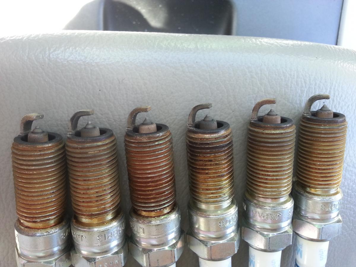

2011edgese Posted April 27, 2015 Author Report Share Posted April 27, 2015 (edited) Heres a pic of alll the plugs. Engine is running healthy. Number 4 cylinder has a slight dark carbon on it. When i tried to remove the stuck boot on it and failed, i put it back but the coil spring was not aligned properly, and it didnt fire for s minute or so. So it almost fouled the plug. Removing the coil and setting the sprint straight and plugging it in again solved that issue. Edited April 27, 2015 by 2011edgese Quote Link to comment Share on other sites More sharing options...
2011edgese Posted April 27, 2015 Author Report Share Posted April 27, 2015 (edited) From left to right. 123456 also makes total sense. This car had a loss of power at 4000rpm around 55 to 60mph. Uphill mostly. It was brief but you could feel it,but once it left around 4400rpm it would fire all 6 cylinders smooth. I put a new battery and it fixed that issue. I couldn't figure why though. Then llooking at the old plug gap, it makes sense. The gap should be around .050. But these old ones are aroung .065 to .075. Just worn out. Longer gap, weaker spark. Specially with a tired battery. Edited April 27, 2015 by 2011edgese Quote Link to comment Share on other sites More sharing options...

macbwt Posted April 27, 2015 Report Share Posted April 27, 2015 How many miles on those plugs? They look like they have well over 100k on them. Mine looked just slightly worse with 150k miles. Great feeling once you finish though!! See that PCV wanted to have some attention and you ignored it. LOL. Quote Link to comment Share on other sites More sharing options...
2011edgese Posted April 27, 2015 Author Report Share Posted April 27, 2015 91,540 miles. Hahaha.. ya, i thought of you when i saw it umplugged. I thought " it will fail soon." Quote Link to comment Share on other sites More sharing options...
