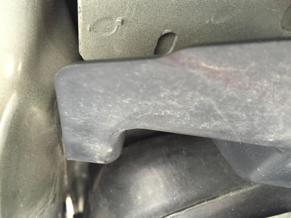

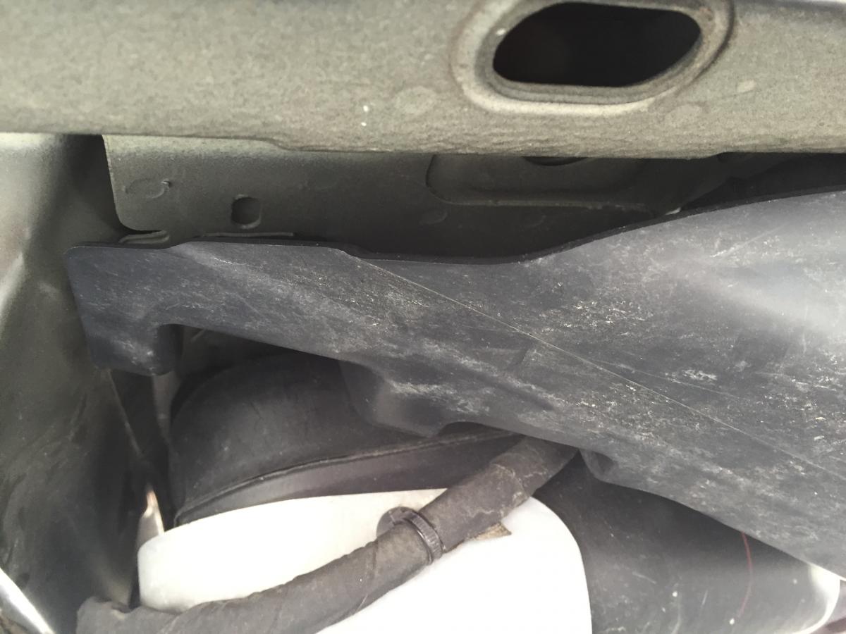

LEXiiON Posted May 25, 2015 Report Share Posted May 25, 2015 I found it.... It is a cover underneath the car. The rear pushpin got loose and the cover will flatter while driving fast. Some 3M tape and re-inserting the pushpin fixed the rattle. The cover scratched the paint on the floor. Test drove and rattle is gone.. LEXiiON 4 Quote Link to comment Share on other sites More sharing options...
WingNut Posted May 25, 2015 Author Report Share Posted May 25, 2015 Awesome. Which pic is when it is fixed? And can you provide more info on exact location of this cover. Thanks. Quote Link to comment Share on other sites More sharing options...
LEXiiON Posted May 25, 2015 Report Share Posted May 25, 2015 The cover is underneath the rear door (towards the end of the door) on the bottom floor. It's a black plastic. You can tap on it and if it moves, that's your problem. There is a psuhpin on the rear end ... you can either push it back in (which i doubt will solve the issue...it might come loose again) or remove it, clean the floor and the cover and apply some 3M tape. Push the whole thing back in.... I assume, the passenger side cover will start to rattle soon, too. Same concept, same pushpin issue... i will fix it, when i hear rattle from that side, too. On the first picture, you can see some of the 3M tape to the left.... LEXiiON Quote Link to comment Share on other sites More sharing options...

WingNut Posted May 25, 2015 Author Report Share Posted May 25, 2015 So I did the fix likr Lexiicon and the rattle is gone. That front pushpin is where my rattle is at. Pulled the pin, cleaned the surface, put some 3m tape on it, and reinstall. That pushpin isn't doing anything for support. Bad design. Quote Link to comment Share on other sites More sharing options...
Wedgeamatic Posted May 25, 2015 Report Share Posted May 25, 2015 Hey guys sorry for being so stupid. But I'm not grasping where this is exactly; the rear tailgate door? Or rear passenger doors? Could you possible show a panned out photo? Sorry to be a pain. Quote Link to comment Share on other sites More sharing options...
WingNut Posted May 25, 2015 Author Report Share Posted May 25, 2015 (edited) Wedge, If you are looking at the rear passenger door.....drivers side. The cover runs from about the middle of the door to the rear of the door. This is actually under the car but right against the drivers side of the car. If you lay on your back with your head under your car at the middle of the rear door, you will see the black plastic cover we are talking about. It has on plastic pushpin holding it to the frame toward the front of the vehicle. Then as the cover goes toward the rear, it gets wide. So no not the tailgate. Edited May 25, 2015 by WingNut Quote Link to comment Share on other sites More sharing options...

LEXiiON Posted May 26, 2015 Report Share Posted May 26, 2015 Yup That's the one. LEXiiON Quote Link to comment Share on other sites More sharing options...
